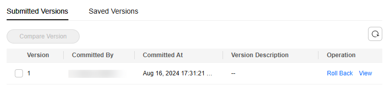

- On the right of the page, click the Versions tab and view the version submission records. Select the version to be rolled back and click Roll Back.

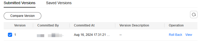

- On the right of the page, click the Versions tab and view the version submission records. Select the versions to be compared and click Compare Version.
If you select only one version, the selected version is compared with the JSON of the development-state job. If you select two versions, the JSON of the two versions is compared.
