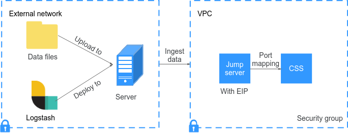

Ingesting Data When Logstash Is Deployed on an External Network
Figure 1 illustrates the data ingestion process when Logstash is deployed on an external network.
- Create a jump host and configure it as follows:
- The jump host is an ECS running a Linux OS and an EIP has been associated with it.
- The jump host resides in the same VPC as the destination cluster.
- SSH local port forwarding is configured for the jump host to forward requests from a chosen local port to port 9200 on one node of the CSS cluster.
- Refer to SSH documentation for the local port forwarding configuration.
- Use PuTTY to log in to the jump host via its EIP.
- Run the following command to configure port mapping to forward requests sent to the opened port on the jump host to the destination cluster:

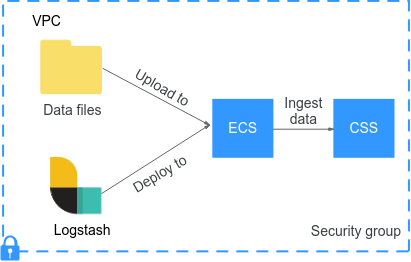

Ingesting Data When Logstash Is Deployed Using an ECS
Figure 2 illustrates the data ingestion process when Logstash is deployed on an ECS that resides in the same VPC as the destination cluster.
- Make sure the ECS where Logstash is deployed and the destination cluster reside in the same VPC, port 9200 is opened in the ECS's security group to allow external network access, and an EIP has been associated with the ECS.
- If there are multiple servers in a VPC, you only need to associate an EIP with one of these servers. Switch to the node where Logstash is deployed from the node with which the EIP is associated.
- If a private line or VPN is available, there is no need for an EIP.
- Use PuTTY to log in to the ECS. For example, the file access_20181029_log is stored in the /tmp/access_log/ path of the ECS, and the file contains the following data:

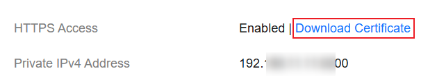

Obtaining the Security Certificate
To access a security-mode OpenSearch cluster that uses HTTPS, perform the following steps to obtain the security certificate CloudSearchService.cer if it is required.
- Log in to the CSS management console.
- In the navigation pane on the left, choose Clusters > OpenSearch.
- In the cluster list, click the name of the target cluster. The cluster information page is displayed.
- Click the Overview tab. In the Network Information area, click Download Certificate below HTTPS Access. Figure 3 Downloading a security certificate
