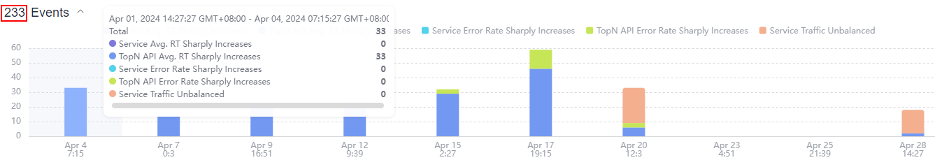

- In the upper left corner of the graph, view the total number of abnormal events detected during inspection in the specified period.
- Move the pointer to the bar graph to view the number of events of each type at a specific time point.
- Click a legend above the bar graph to hide or display a certain type of events.

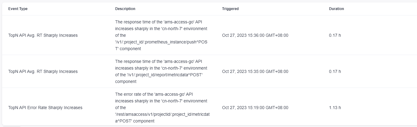

The abnormal events detected by intelligent patrol in the specified period are displayed in a list. Each event contains the following information:
- Event Type: type of an event.
- Application: application to which the event belongs.
- Root Cause Component: component that causes the event.
- Description: describes the component and interface where the event occurs.
- Triggered: time when an exception first occurs.
- Duration: the period for which the exception lasts.
- Status: status of the event during intelligent patrol.

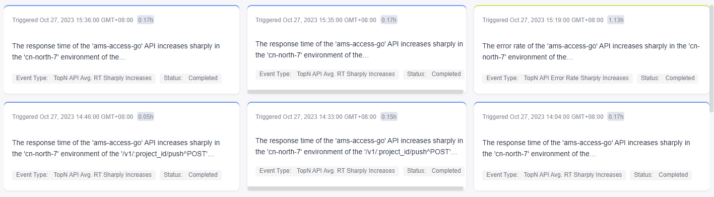

The abnormal events detected by intelligent patrol in the specified period are displayed on cards. Each card contains the following information:

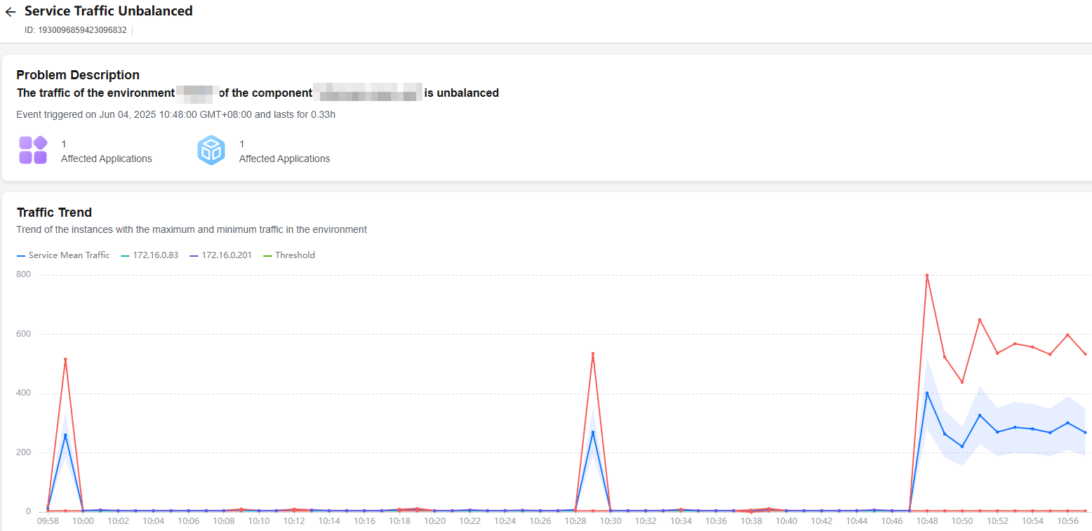

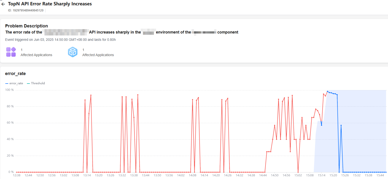

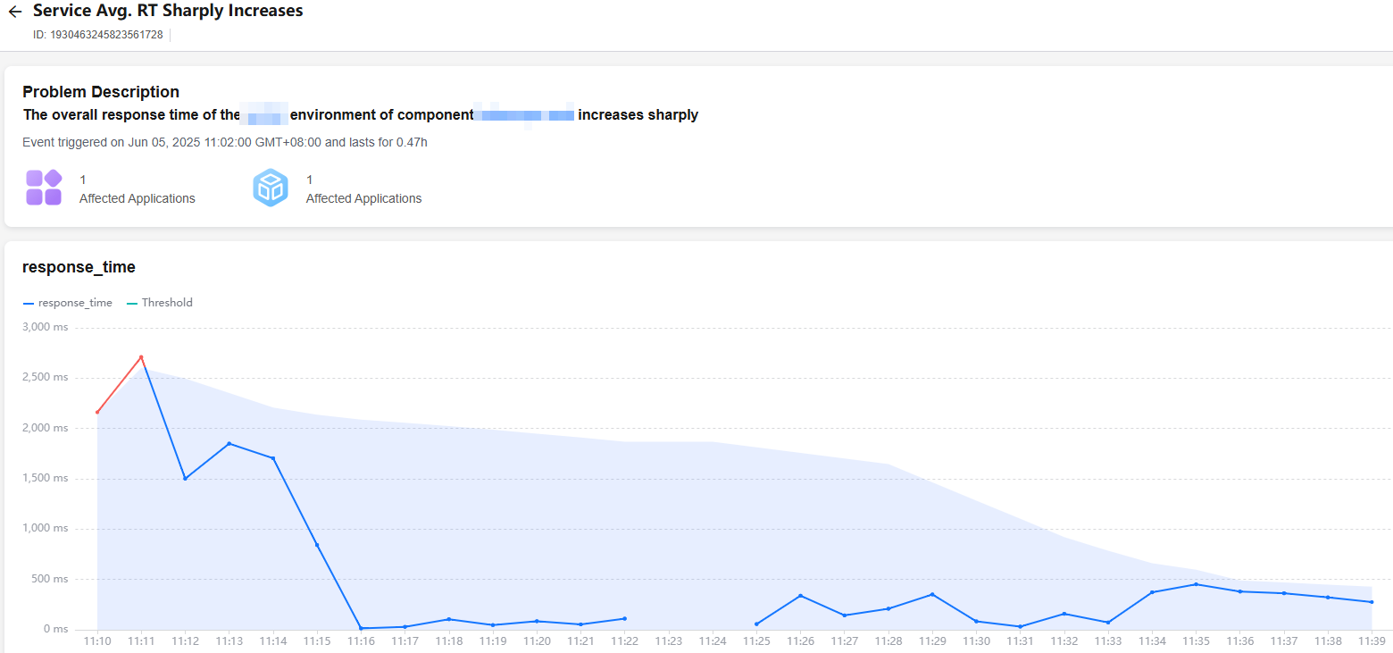

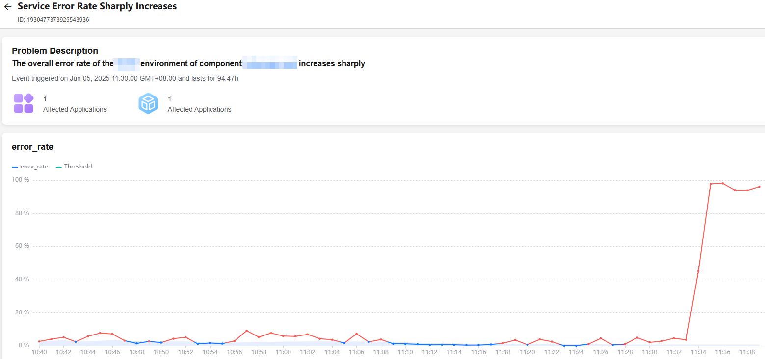

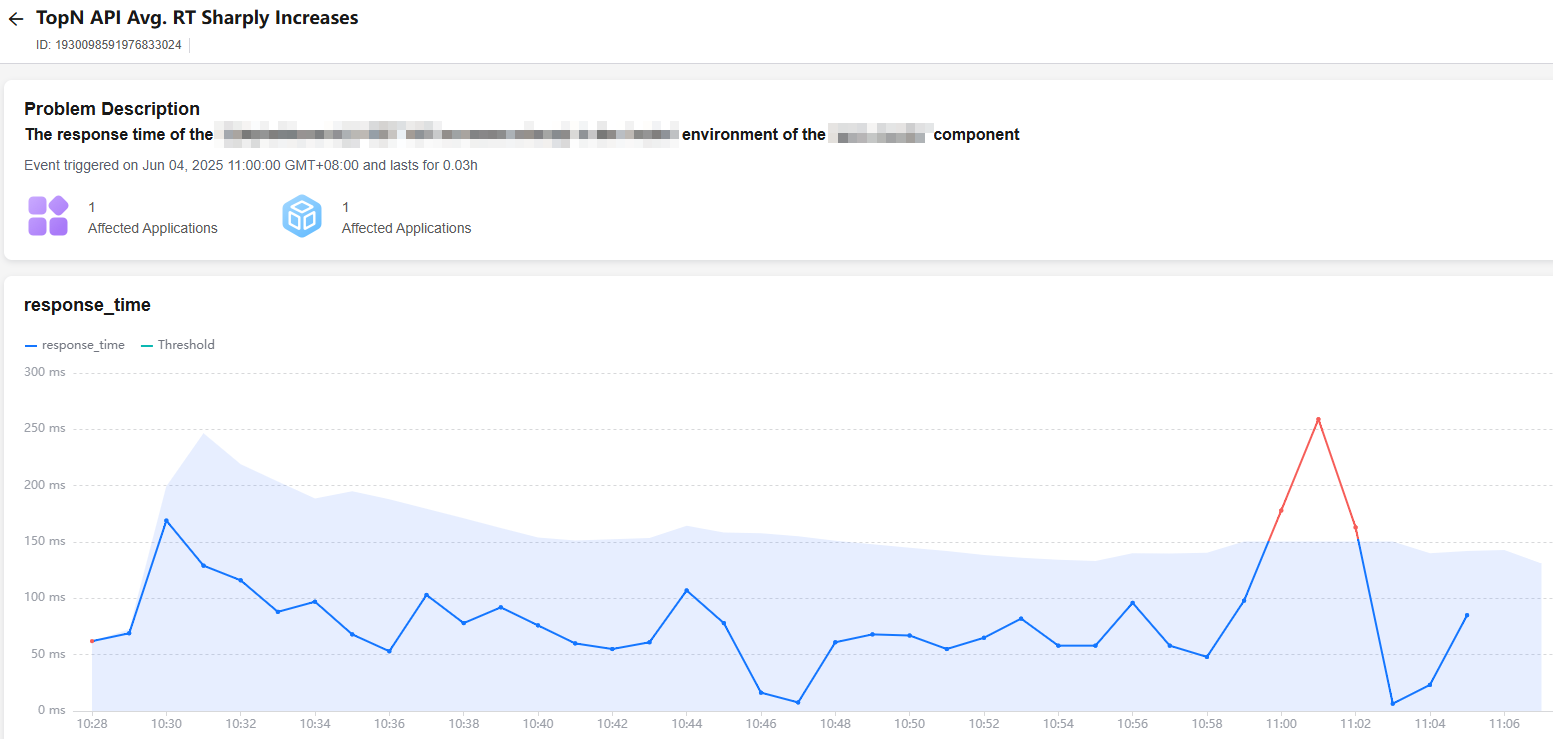

- View the details of an event. Click an event type name in the list or on the card to go to the event details page.
On the event details page, graphs about key metrics such as RT and error rate are displayed, showing the duration for which an exception lasts, time when the exception first occurs, and upper limit. (You can click the component, environment, or API name under Problem Description on the event details page to go to the corresponding details page. Only the AP-Singapore region supports the redirection to the component details page.)
