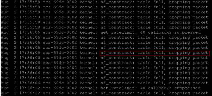

Packet loss occasionally occurs when you connect to applications in an ECS. The kernel: nf_conntrack:table full, dropping packet is printed in /var/log/messages system logs.
Figure 1 System logs
