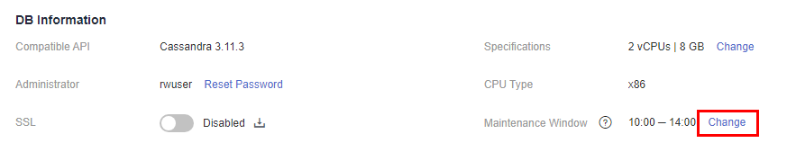

- In the DB Information area, locate Maintenance Window and click Change.
Figure 1 The change button

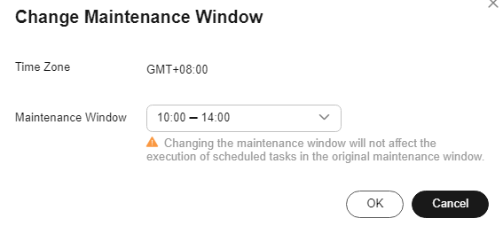

- On the Change Maintainable Window page, select the maintenance time period as needed, and then click OK.
Supported time periods: 02:00-06:00, 06:00-10:00, 10:00-14:00, 14:00-18:00, 18:00-22:00, and 22:00-02:00
Figure 2 Changing a maintenance window - Check the result.
On the Basic Information page, you can view the changed maintenance window.

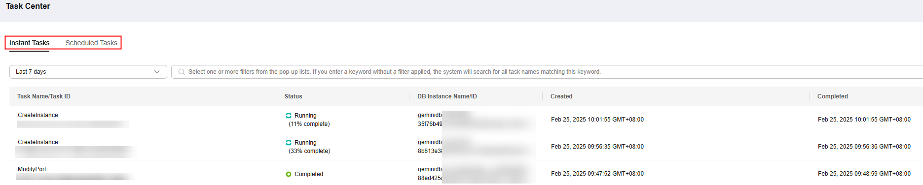

Querying an Executed Task
- Log in to the Huawei Cloud console.
- In the service list, choose Databases > GeminiDB.
- On the Task Center page, click the Instant Tasks or Scheduled Tasks tab to view a task.
Figure 3 Querying a task

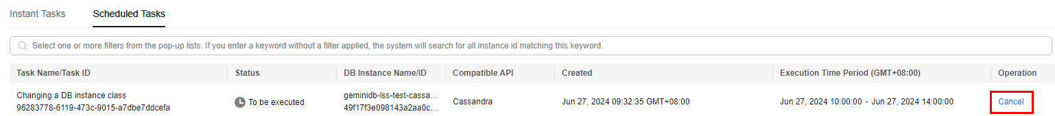

Canceling a Scheduled Task
- On the Task Center page, locate a scheduled task, and click Cancel in the Operation column.
Figure 4 Canceling a task

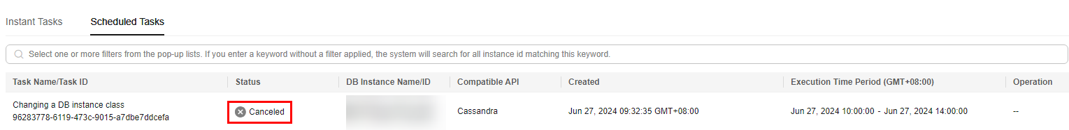

- Check the result.
On the Task Center page, you can view the result. After the task is cancelled, its status changes to Cancelled.
Figure 5 Checking cancelled tasks
