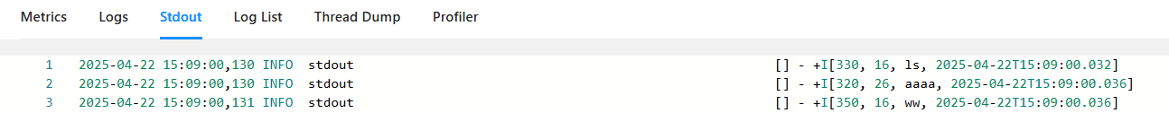

CREATE TABLE age_table( id int, `age` int, PRIMARY KEY(id) NOT ENFORCED ) WITH ( 'connector' = 'mysql-cdc', 'hostname' = '8.5.193.13', 'port' = '3306', 'username' = 'root', 'password' = '', 'database-name' = 'test', 'table-name' = 'age_table' ); CREATE TABLE name_table( id int, `name` string, PRIMARY KEY(id) NOT ENFORCED ) WITH ( 'connector' = 'mysql-cdc', 'hostname' = '8.5.193.13', 'port' = '3306', 'username' = 'root', 'password' = '', 'database-name' = 'test', 'table-name' = 'name_table' ); CREATE TABLE PrintSink( id int, `age` int, `name` string, currentdata timestamp, PRIMARY KEY(id) NOT ENFORCED ) WITH ('connector' = 'print'); insert into PrintSink select a.id * 10 as id, a.`age`, b.`name`, now() from age_table a join name_table b on a.id = b.id; - The following figure shows the information printed when a job is started.

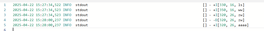

 - Run the following command to update data in the table:
update name_table set name='aaaa' where id=32;

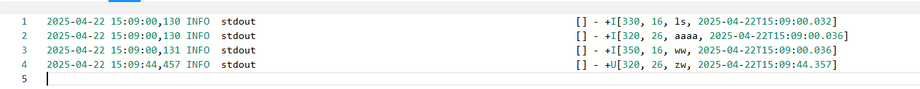

 - Check the updated output. The printed data contains only +U but not -U. After multiple attempts, it was found that there was no -U data in the result. It was suspected that SinkUpsertMaterializer is intercepting the -U data.
 - After an analysis of the SQL and SinkUpsertMaterializer principles, it was found that the issue was caused by the now() function in the SQL. The now() function returned the current time each time it was called, so the data that entered the SinkUpsertMaterializer operator was always different. The issue was resolved after the now() function was removed.
