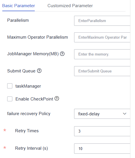

- On the job development page, click Basic Parameter. In the failure recovery Policy area, select a policy from the drop-down list, and set the related parameters.
- If you select fixed-delay, you need to configure Retry Times and Retry Interval (s).
- If you select failure-rate, you need to configure Max Retry Times, Interval (min), and Retry Interval (s).
- If you select none, no other parameters need to be set.
