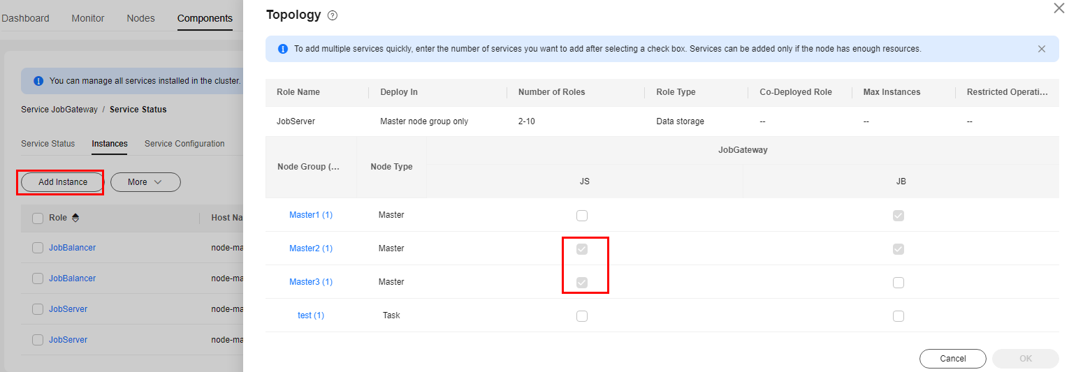

- Add two JobServer instances to Master nodes. Specifically, add one JobServer instance to each of the Master2 and Master3 nodes by default.
- Log in to the MRS management console. On the displayed page, click the name of the target MRS cluster.
 - Click the Components tab. On this tab, click the JobGateway service. On the displayed page, click Instances. Click Add Instance and add JobServer instances to the Master nodes.
       Ensure that Master2 and Master3 nodes each have more than 4 GB of reserved memory. Otherwise, the JobServer instance process may fail to start.
