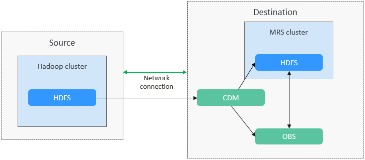

Solution Architecture
Figure 1 Hadoop data migration
CDM supports both full and incremental file migration. Full migration is implemented by copying files. You can implement incremental migration by setting Duplicate File Processing Method to Skip.
  • Full migration
    • Create two links on CDM to connect HDFS of the source cluster and the HDFS or OBS file system of Huawei Cloud MRS.
    • Create a full migration job on CDM, configure source and destination parameters, and start the job.
  • Incremental migration
    • Create a migration job on CDM again. When configuring destination parameters, select Skip for Duplicate File Processing Method.
    • Start the migration job.

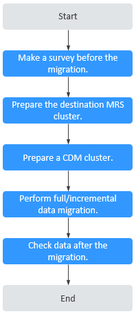

The process for using CDM to migrate Hadoop data to an MRS cluster is as follows.
Figure 2 Data migration process

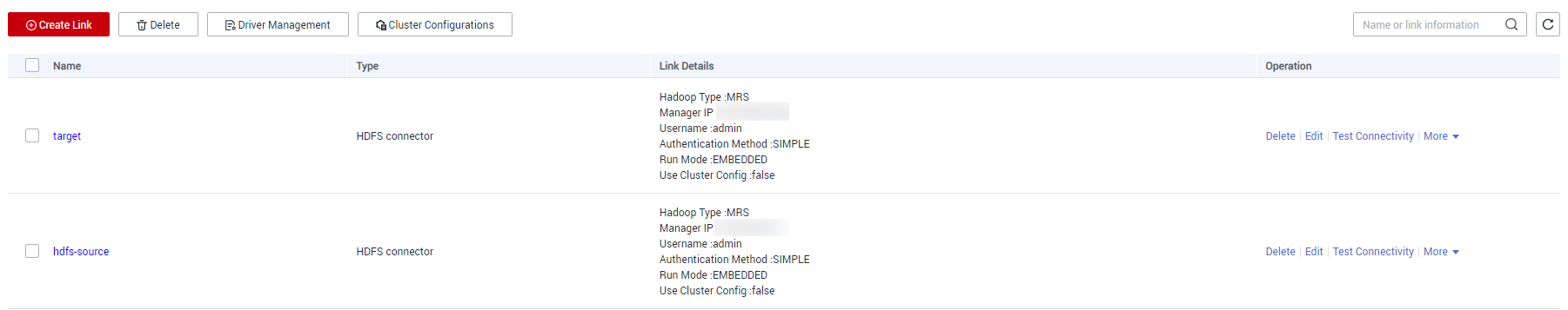

  4. On the Links tab page, click Create Link.
  5. Create two HDFS links, one to the source cluster and the other to the destination cluster. For details, see Creating a Link Between CDM and a Data Source.
    Set the connector type based on the actual cluster. For an MRS cluster, select MRS HDFS. For a self-built cluster, select Apache HDFS.
    Figure 3 HDFS link

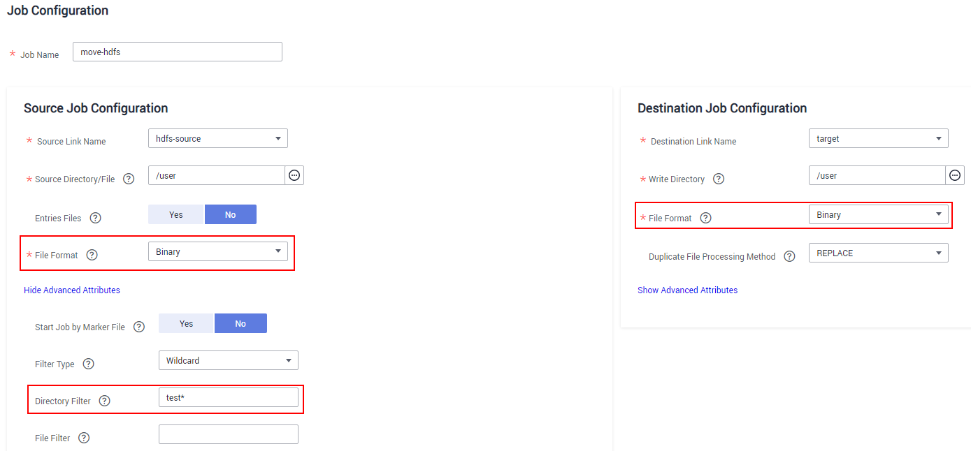

  3. Configure source job parameters by referring to From HDFS. You can set Directory Filter and File Filter to specify the directories and files to be migrated.
    • If you use CDM to perform full data migration, select REPLACE for Duplicate File Processing Method in the Destination Job Configuration area.
    • If you use CDM to perform incremental data migration, select Skip for Duplicate File Processing Method in the Destination Job Configuration area.
    For example, if you need to migrate files in the /user/test* folder, set File Format to Binary.
    Figure 4 Configuring job parameters

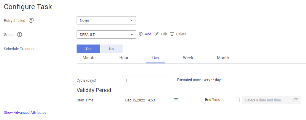

  5. Click Next. The task configuration page is displayed.
    • If you need to periodically migrate new data to the destination cluster, configure a scheduled task on this page. Alternatively, you can configure a scheduled task later by referring to 3.
    • If no new data needs to be migrated periodically, skip the configurations on this page and click Save.
      Figure 5 Task configuration

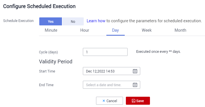

  3. (Optional) If new data in the source cluster needs to be periodically migrated to the destination cluster, configure a scheduled task for incremental data migration until all services are migrated to the destination cluster.
    1. On the Cluster Management page of the CDM console, choose Job Management and click the Table/File Migration tab.
    2. In the Operation column of the migration job, click More and select Configure Scheduled Execution.
    3. Enable the scheduled job execution function, configure the execution cycle based on service requirements, and set the end time of the validity period to the time after all services are migrated to the new cluster.
      Figure 6 Configuring schedule execution
