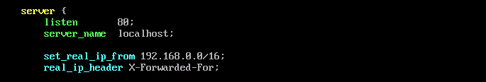

  4. Modify the server configuration block as follows:
    set_real_ip_from 192.168.0.0/16;
    real_ip_header X-Forwarded-For;
    Figure 1 Adding information
    You need to enter the CIDR block of the proxy server as the value of set_real_ip_from. For dedicated load balancers, enter the CIDR block of its backend subnet.

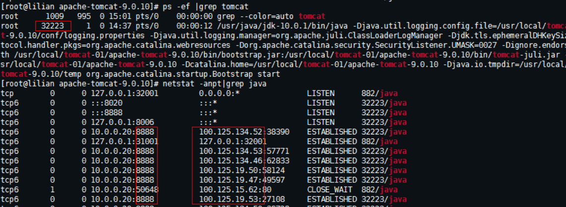

  1. Log in to a server on which Tomcat is installed.
  2. Check whether Tomcat is running properly.
    ps -ef|grep tomcat
    netstat -anpt|grep java
    Figure 3 Tomcat running properly

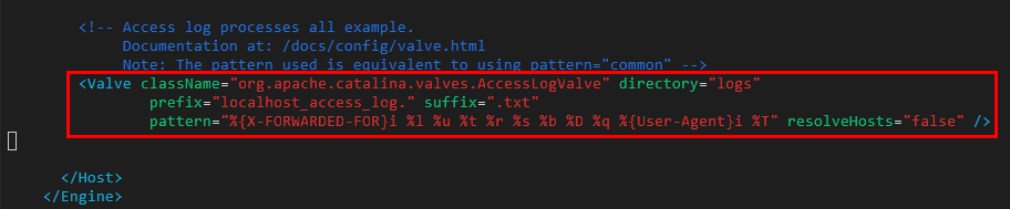

  3. Modify className="org.apache.catalina.valves.AccessLogValve" in the server.xml file as follows:
    1. Run the following command to open the server.xml file:
      vim /usr/tomcat/tomcat8/conf/server.xml
    2. Modify the file as follows:
      <Valve className="org.apache.catalina.valves.AccessLogValve" directory="logs"
      prefix="localhost_access_log." suffix=".txt"
      pattern="%{X-FORWARDED-FOR}i %l %u %t %r %s %b %D %q %{User-Agent}i %T" resolveHosts="false" />
    Figure 4 Example configuration

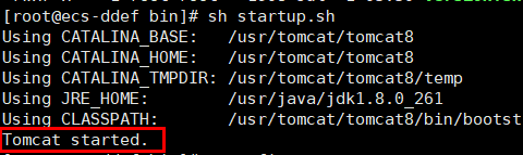

  4. Restart the Tomcat service.
    cd /usr/tomcat/tomcat8/bin && sh shutdown.sh && sh startup.sh
    /usr/tomcat/tomcat8/ is where Tomcat is installed. Change it based on site requirements.
    Figure 5 Restarting the Tomcat service

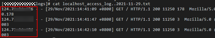

  5. View the latest logs.
    As highlighted in the following figure, IP addresses shown in the red box are the client IP addresses.
    cd /usr/tomcat/tomcat8/logs/
    cat localhost_access_log.2021-11-29.txt
    In this command, localhost_access_log.2021-11-29.txt indicates the log path of the current day. Change it based on site requirements.
    Figure 6 Checking the client IP addresses

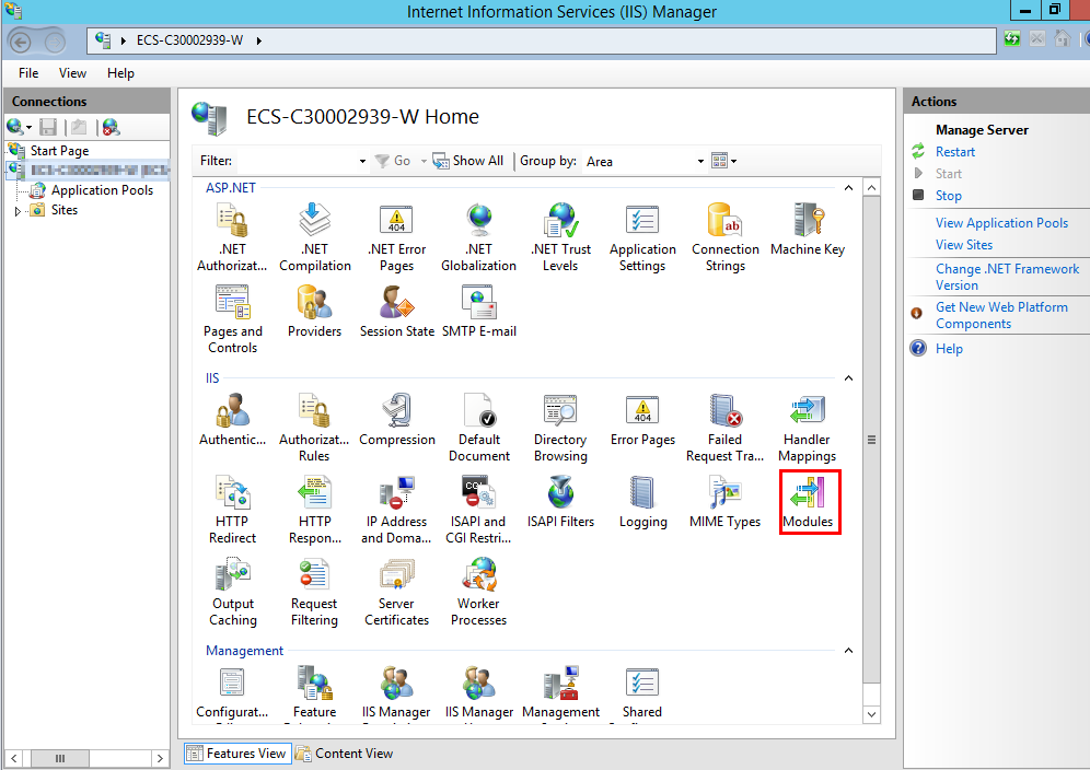

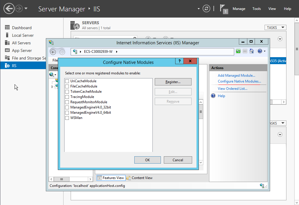

  3. Open Internet Information Services (IIS) Manager and choose Modules > Configure Native Modules.
    Figure 7 Selecting Modules
    Figure 8 Configure Native Modules

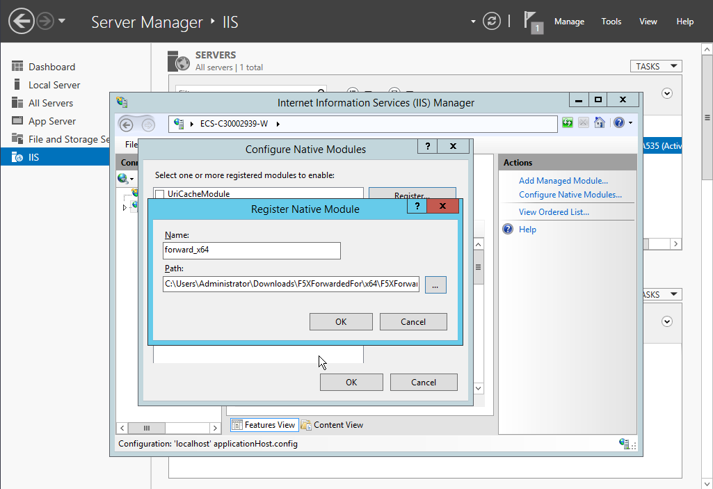

  4. Click Register to register the x86 and x64 plug-ins.
    Figure 9 Registering plug-ins

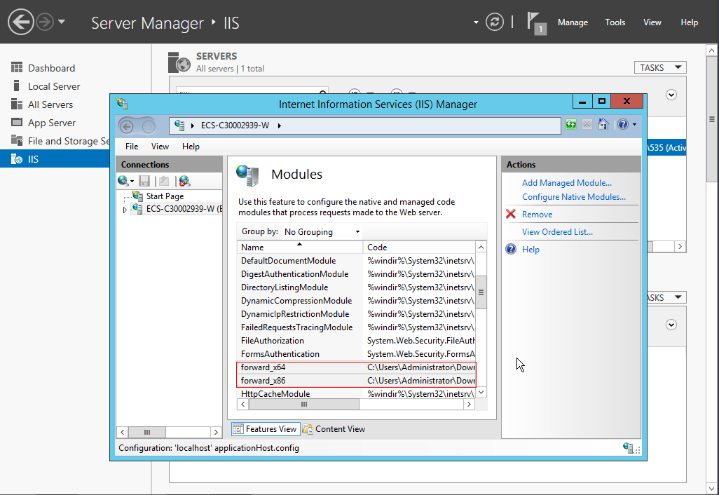

  5. In the Modules dialog box, verify that the registered plug-ins are displayed in the list.
    Figure 10 Confirming the registration

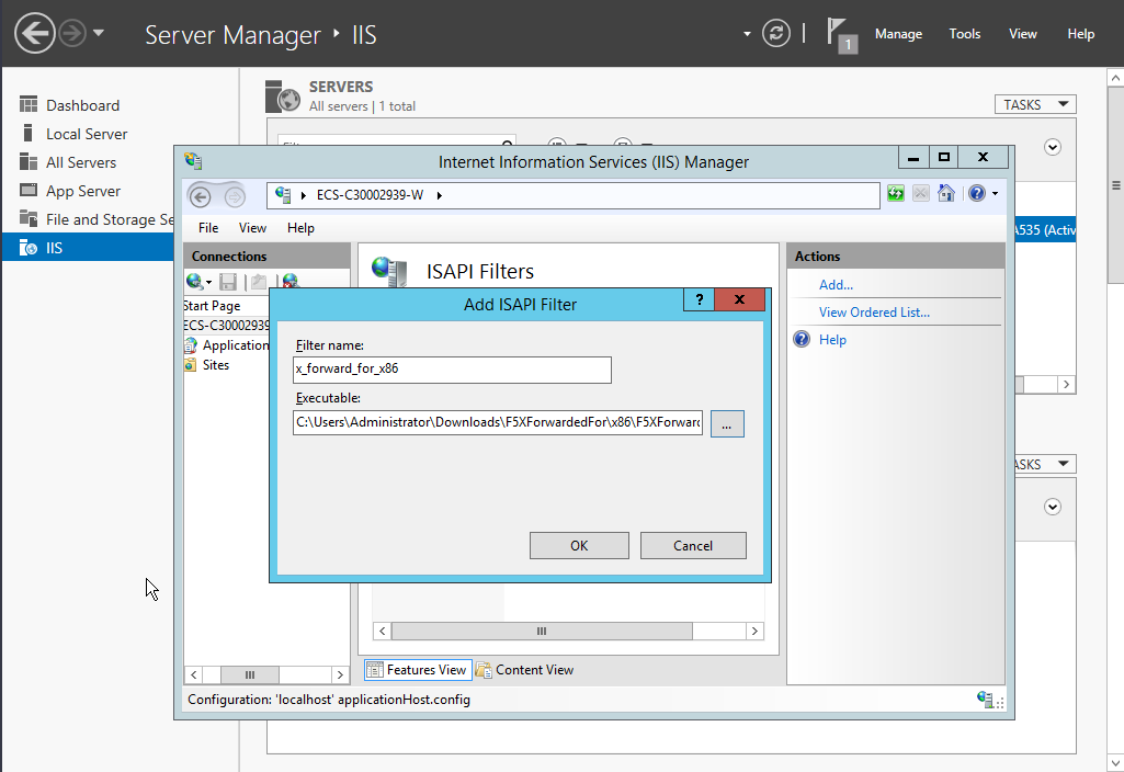

  6. Select ISAPI Filters on the Internet Information Services (IIS) Manager homepage and authorize two plug-ins to run ISAPI and CGI extensions.
    Figure 11 Adding authorization

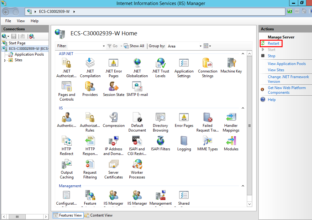

  8. Click Restart on the homepage to restart IIS. The configuration will take effect after the restart.
    Figure 13 Restarting IIS
