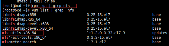

  1. Log in to the ECS and check whether the nfs-utils package is installed. Run the following command. If no command output is displayed, the package is not installed.
    rpm -qa|grep nfs
    Figure 1 Checking whether the software package has been installed

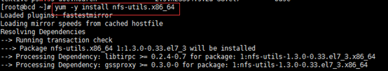

  2. Run the following command to install the nfs-utils software package:
    yum -y install nfs-utils
    Figure 2 Executing the installation command
    Figure 3 Successful installation
