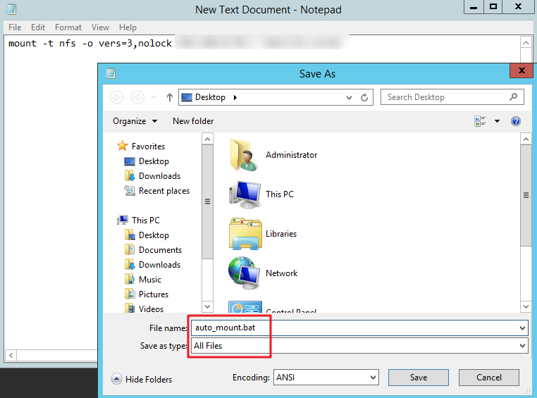

  3. Before mounting the file system, create a script named auto_mount.bat, save the script to a local host, and record the save path. The script contains the following content:
    mount -o nolock mount point corresponding drive letter
    Figure 1 Saving the script
    For example, the auto_mount.bat script of a file system contains the following content:
    • You can copy the mount command of the file system from the console.
    • After the script is created, manually run the script in the Command Prompt to ensure that the script can be executed successfully. If you can view the file system in This PC after the script execution, the script can be executed properly.
    • This .bat script cannot be stored in the same path in 4 that stores the .vbs file. In this example, the .bat script is stored in C:\test\.

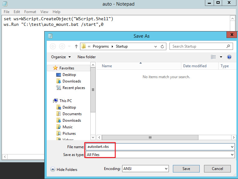

  4. Create a .txt file whose name is XXX.vbs and save the file to the directory C:\Users\Administrator\AppData\Roaming\Microsoft\Windows\Start Menu\Programs\Startup. The file contains the following content:
    set ws=WScript.CreateObject("WScript.Shell")
    ws.Run "Local path and script name of the auto_mount.bat script /start", 0
    Figure 2 Creating .vbs file
    In this example, the local path of the auto_mount.bat script is C:\test\. Therefore, the content in the .vbs file is as follows:
    ws.Run "C:\test\auto_mount.bat /start",0
