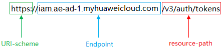

Request URI
A request URI is in the following format:
{URI-scheme} :// {Endpoint} / {resource-path} ? {query-string}
Although a request URI is included in the request header, most programming languages or frameworks require the request URI to be transmitted separately.
- URI-scheme:
Protocol used to transmit requests. All APIs use HTTPS.
 - Endpoint:
Domain name or IP address of the server bearing the REST service. The endpoint varies between services in different regions. It can be obtained from Regions and Endpoints.
For example, the endpoint of IAM in the ae-ad-1 region is iam.ae-ad-1.myhuaweicloud.com.
 - resource-path:
Access path of an API for performing a specified operation. Obtain the path from the URI of an API. For example, the resource-path of the API used to obtain a user token is /v3/auth/tokens.
 - query-string:
Query parameter, which is optional. Ensure that a question mark (?) is included before each query parameter that is in the format of "Parameter name=Parameter value". For example, ?limit=10 indicates that a maximum of 10 data records will be displayed.
For example, to obtain an IAM token in the ae-ad-1 region, obtain the endpoint of IAM (iam.ae-ad-1.myhuaweicloud.com) for this region and the resource-path (/v3/auth/tokens) in the URI of the API used to obtain a user token. Then, construct the URI as follows:
         https://iam.ae-ad-1.myhuaweicloud.com/v3/auth/tokens  |
