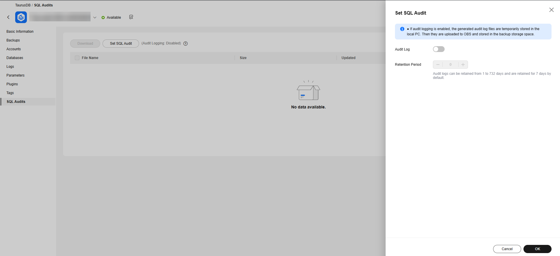

    1. On the TaurusDB console, click the DB instance name. On the displayed page, click SQL Audits.
    2. Click Set SQL Audit.
    3. In the displayed dialog box, toggle on the audit log switch and set the number of days to retain audit logs.
      Figure 1 Setting SQL audit
