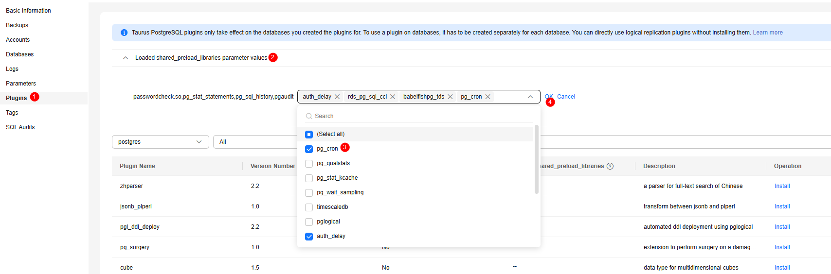

  2. Choose Plugins and add pg_cron to the shared_preload_libraries parameter values.
    Figure 1 Plugins

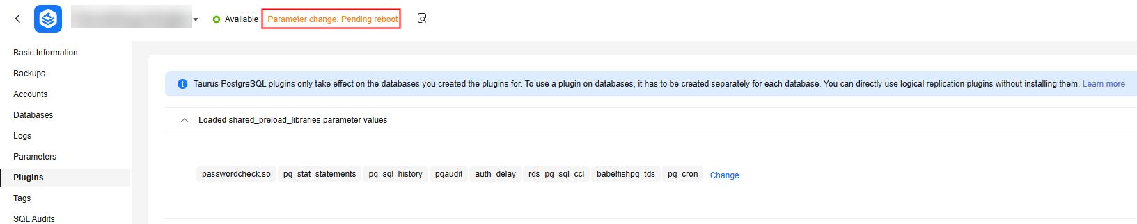

  3. Reboot the DB instance for the modification to be applied.
    Figure 2 Extension added

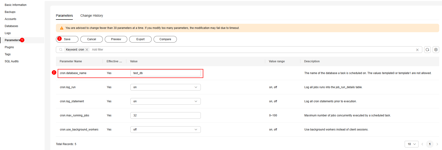

  4. If the extension is not to be installed in the default database postgres, modify the cron.database_name parameter. After modifying cron.database_name, reboot the instance for the modification to be applied.
    The value of cron.database_name must be changed to the name of the database where pg_cron is to be used. For example, if you want to install the extension in the test_db database, change the value of cron.database_name to test_db.
    Figure 3 Changing the parameter value

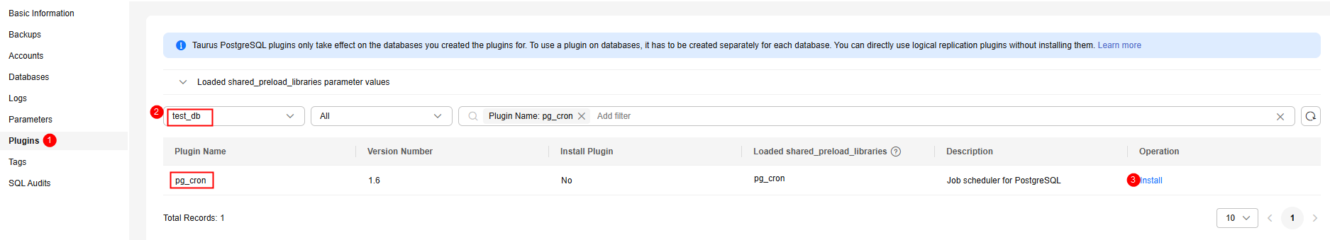

  5. Install the pg_cron extension.
    • Installing pg_cron on the console
      On the Plugins page, select the desired database, search for pg_cron, and click Install.
      Figure 4 Installing pg_cron

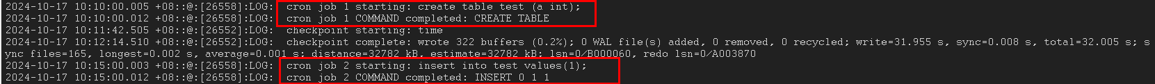

  5. Check whether the scheduled jobs have been successfully executed.
    • Check the logs for successful job execution.

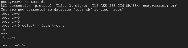

    • Check whether the test table has been created in the test_db database.
      Figure 6 Querying the database
