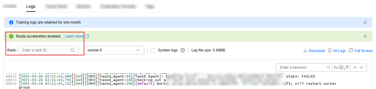

Viewing Training Logs of Dynamic Route Acceleration
When using an Ascend resource pool for training, you can check whether the route is enabled and query the log information of each rank in the Logs tab of the training job details page.
  1. Log in to the ModelArts console.
  2. In the navigation pane, choose Model Build > Training. (On the old console, choose Model Training > Training Jobs.)
  3. In the training job list, click the target job to access its details page.
  4. Click the Logs tab.
    You can view that dynamic routing has been enabled for the training job and search for logs by rank ID.
    Figure 1 Viewing dynamic route acceleration logs
