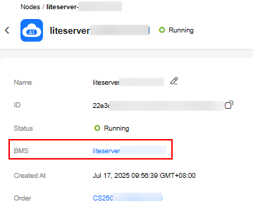

- On the Lite Server details page, click the BMS address or ECS address to access its details page. Figure 1 Lite Server details page
