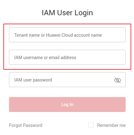

 - Prepare the tenant ID and IAM ID for OBS bucket configuration.
Send the prepared information to Huawei technical support, who will configure an OBS bucket policy based on your information. You can upload the collected logs to the corresponding OBS bucket.
After the configuration, the OBS directory obs_dir is provided for you to configure subsequent scripts.
Figure 2 Tenant ID and IAM ID

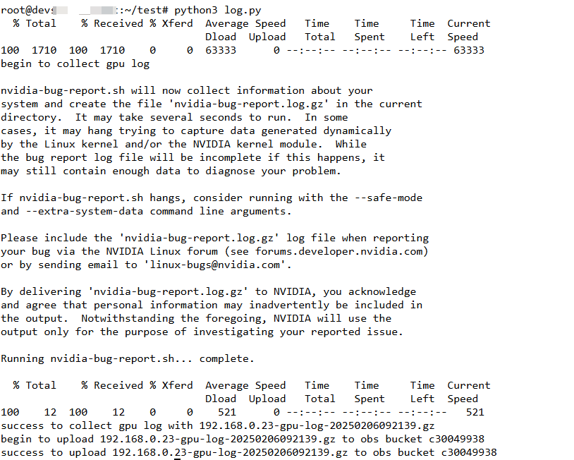

Run the script on the node. If the following information is displayed, logs are collected and uploaded to OBS.
Figure 3 Log collected
