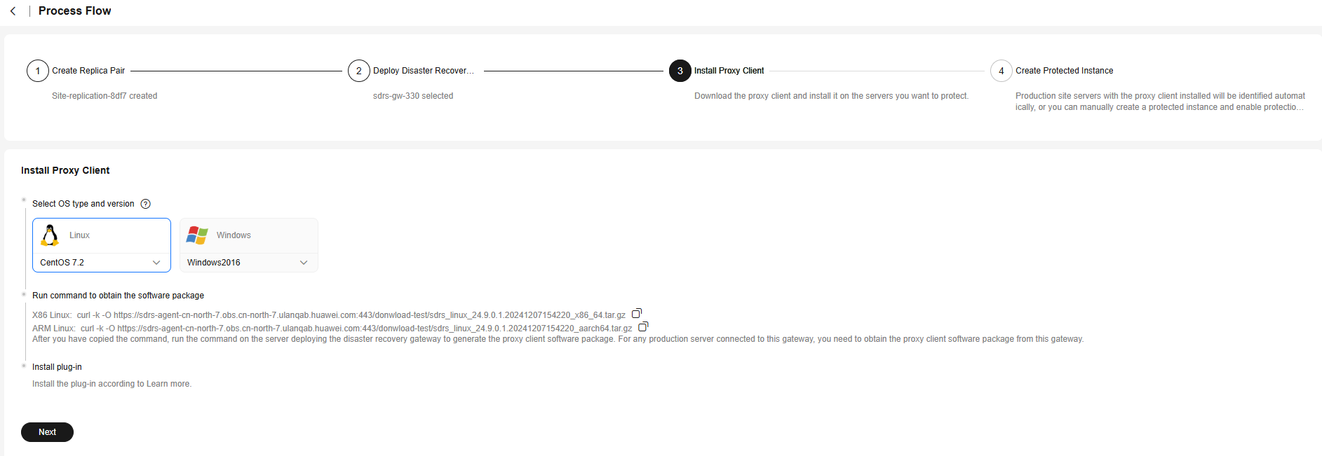

- Obtain the proxy client package and upload it to the /opt/cloud directory on the gateway server. Ensure the package integrity by comparing the SHA256 values in advance.
- IDC-to-cloud: Click the link on the console to download the package and upload it to the /opt/cloud directory of the gateway server.
- Cross-region and Cross-AZ: Select the OS type and version of your production site server on the console and copy the command provided. Then, log in to the gateway server, go to the /opt/cloud directory, and paste and run the command to obtain the package.

Figure 1 Proxy client installation example
