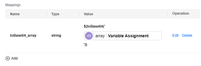

You can reference functions to quickly configure connectors when editing and designing a composite application.
Figure 1 describes how to use functions in composite applications.
