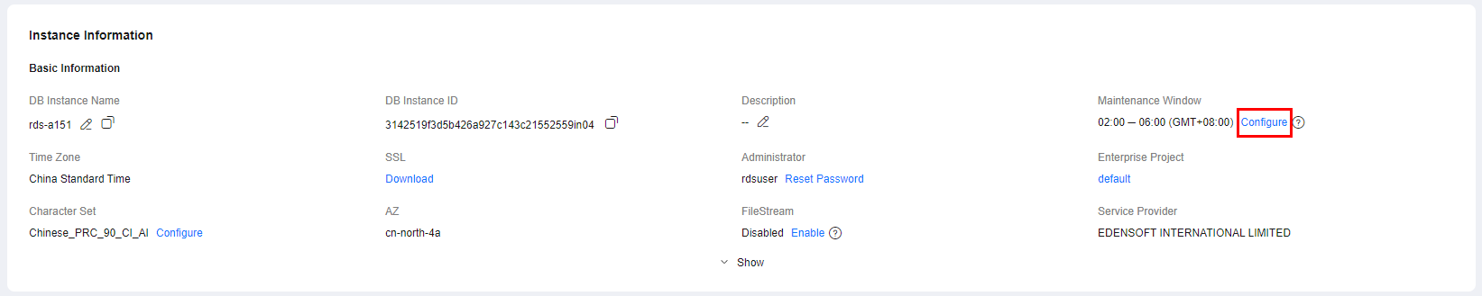

  3. On the Instances page, click the target instance name to go to the Summary page. Under Maintenance Window, click Configure.
    Figure 1 Changing the maintenance window
  4. In the displayed dialog box, select a maintenance window and click OK.
