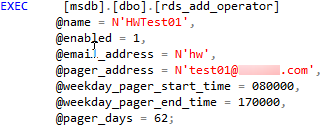

After the command is executed, the system displays the following information.
Commands completed successfully.
Example
The command output is as follows.
