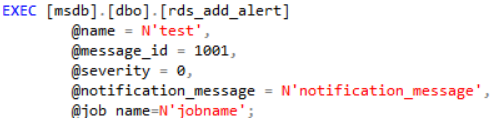

Example
The command output is as follows.
