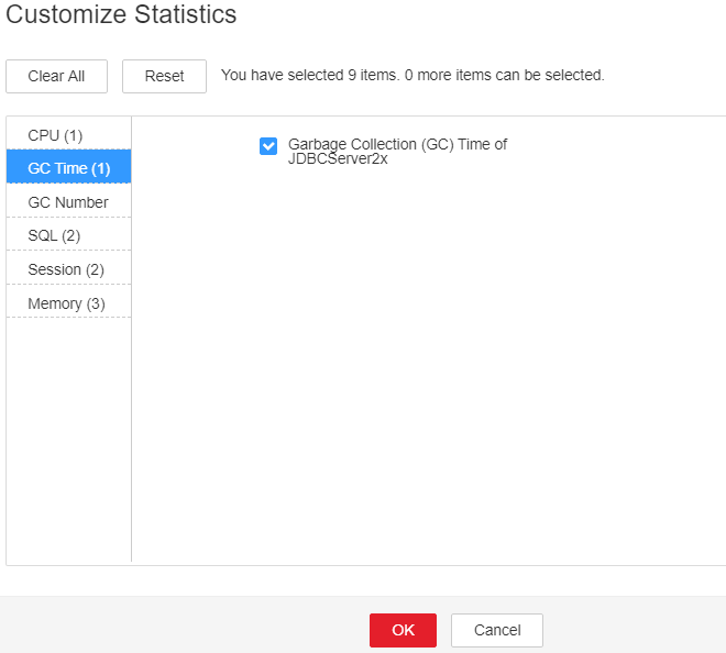

- On the FusionInsight Manager homepage, choose Cluster > Services > Spark2x > Instances and click the JDBCServer2x for which the alarm is generated to go to the Dashboard page. Click the drop-down menu in the Chart area, choose Customize > GC Time > Garbage Collection (GC) Time of JDBCServer2x from the drop-down list box in the upper right corner, and click OK to check whether the GC time is longer than the threshold (default value: 12 seconds).
Figure 1 Garbage Collection (GC) Time of JDBCServer2x
