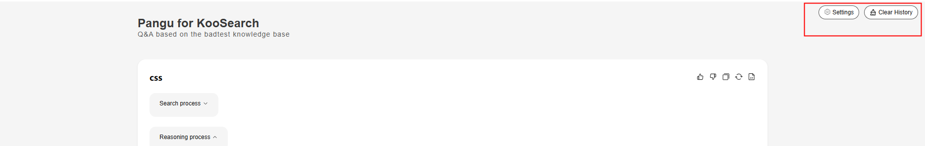

  5. In the upper right corner of the Q&A page, the Settings and Clear History buttons are available.
    Figure 2 Buttons
    • Settings: Click Settings to modify related settings in the middle of a dialog with KooSearch. For more information about the parameters, see Configuring Q&A Settings.
    • Clear History: Click Clear History to clear the current dialog page. After clearing, a new dialog begins by default.
