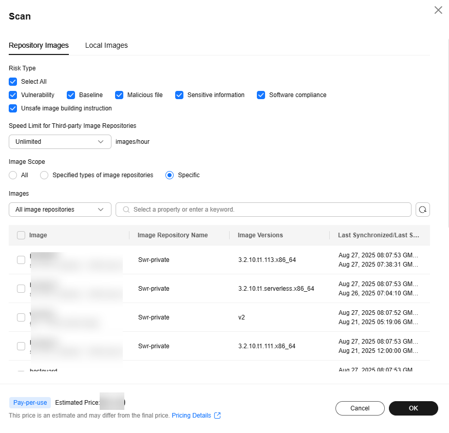

  5. Click the Repository Images tab and configure parameters. For details, see Table 1.
    Figure 1 Manually scanning repository images
    Table 1 Manual scan parameters
    Parameter
    Description
    Example Value
    Risk Type
    Select the risk types to be scanned for. Options are Vulnerability risk, Baseline, Malicious file, Sensitive information, Unsafe image building instruction, and Software compliance.
    HSS scans for software information, file information, and base images by default.
    All
    Speed Limit for Third-party Image Repositories
    If you have many third-party images to scan, but do not want the scan to occupy too much bandwidth, you can click to set the number of images to be scanned per hour.
    Unlimited
    Image Scope
    Select All, Specified types of image repositories, or Specific.
    A full scan takes a long time and cannot be stopped once started. Exercise caution when performing this operation.
    All
  6. Confirm the fees and click OK to start the scan.

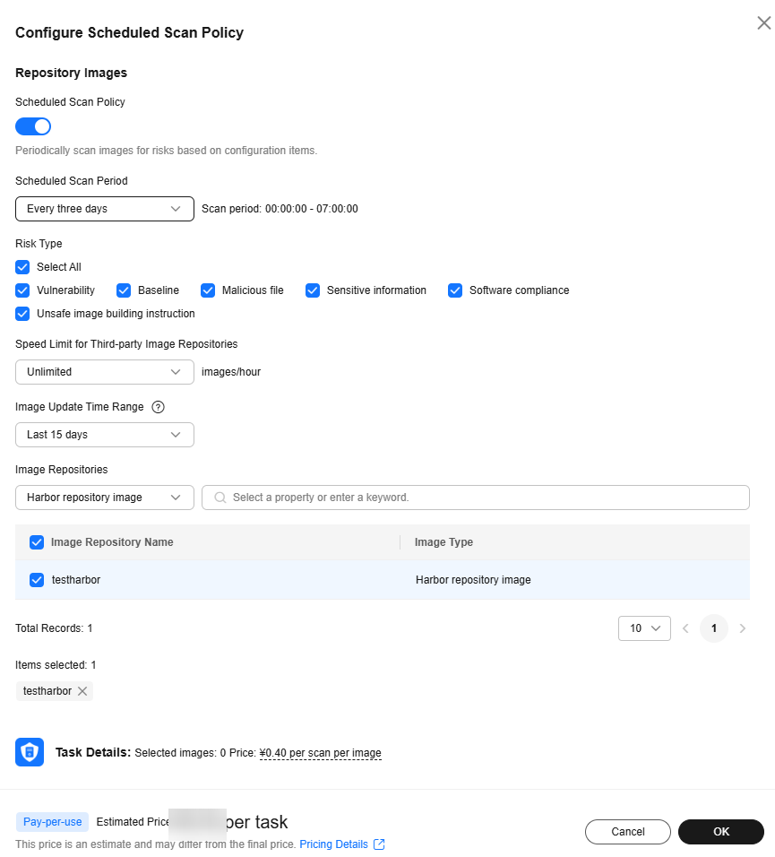

  4. In the upper right part of the page, click Scheduled Scan Policy.
  5. Configure scheduled scan parameters, as shown in Figure 2. For details, see Table 3.
    Figure 2 Scheduled scan policy
    Table 3 Scheduled scan parameters
    Parameter
    Description
    Example Value
    Whether to enable scheduled scan. After this function is enabled, you can view and configure scheduled scan parameters.
    • : disabled
    • : enabled
    Scheduled Scan Period
    Click to set the scan period. The scan time range is fixed to 00:00:00 - 07:00:00.
    Every 3 days
    Risk Type
    All
    If you have many images to scan, but do not want the scan to occupy too much bandwidth, click to set the number of images to be scanned per hour.
    Unlimited
    Image Update Time Range
    Select a range of image update time. It determines which images will be scanned.
    For example, if Last 15 days is selected, HSS will only scan the images updated in the last 15 days.
    Last 15 days
    Image Repositories
    Select image repositories.
    Harbor repository image
