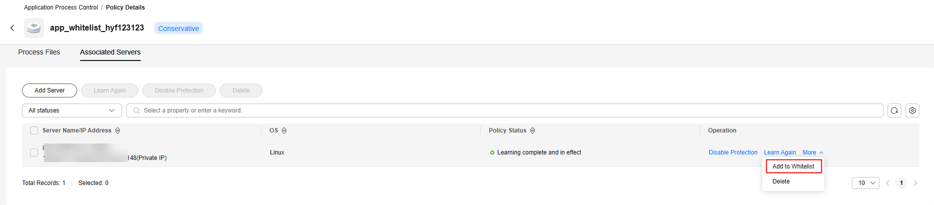

- Click the Associated Servers tab.
- In the row of a server, choose in the Operation column.
Figure 1 Extending the process whitelist
- Click Compare to compare the server process fingerprints with the application processes learned by the whitelist.
- Select trusted processes and click Add.
