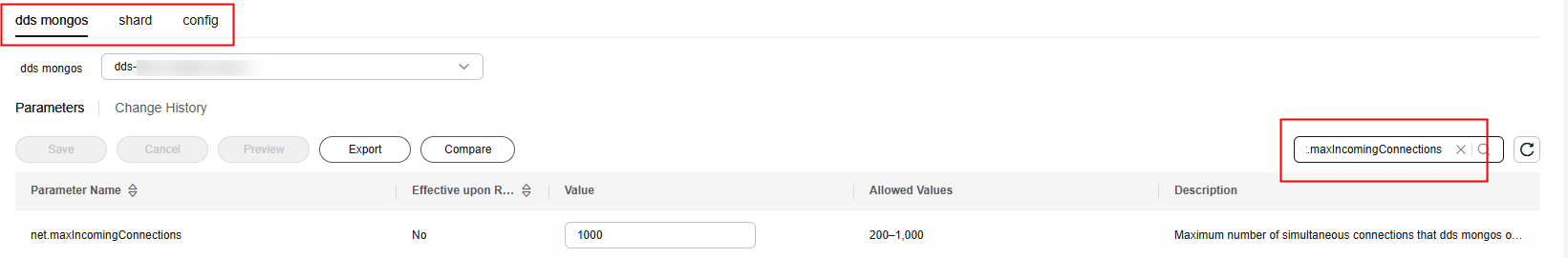

- If the instance is a cluster instance, select the dds mongos, shard, or config node on the Parameters page and change the value of net.maxIncomingConnections. This parameter specifies the maximum number of concurrent connections that dds mongos or mongod can accept.
Enter net.maxIncomingConnections in the search box in the upper right corner of the page and click the search icon to search for this parameter.
Figure 2 Changing the maximum number of connections

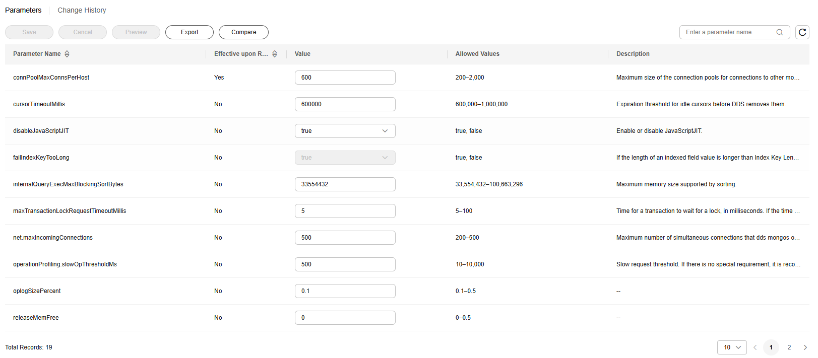

- If the instance is a replica set instance, select Replica set nodes or Read replicas on the Parameters page and change the value of net.maxIncomingConnections. This parameter specifies the maximum number of concurrent connections that dds mongos or mongod can accept.
Figure 3 Changing the maximum number of connections

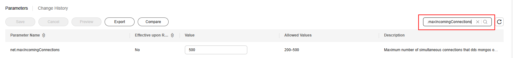

- If the DB instance is a single node instance, change the value of net.maxIncomingConnections, which indicates maximum number of concurrent connections that dds mongos or mongod can be connected.
Figure 4 Changing the maximum number of connections
