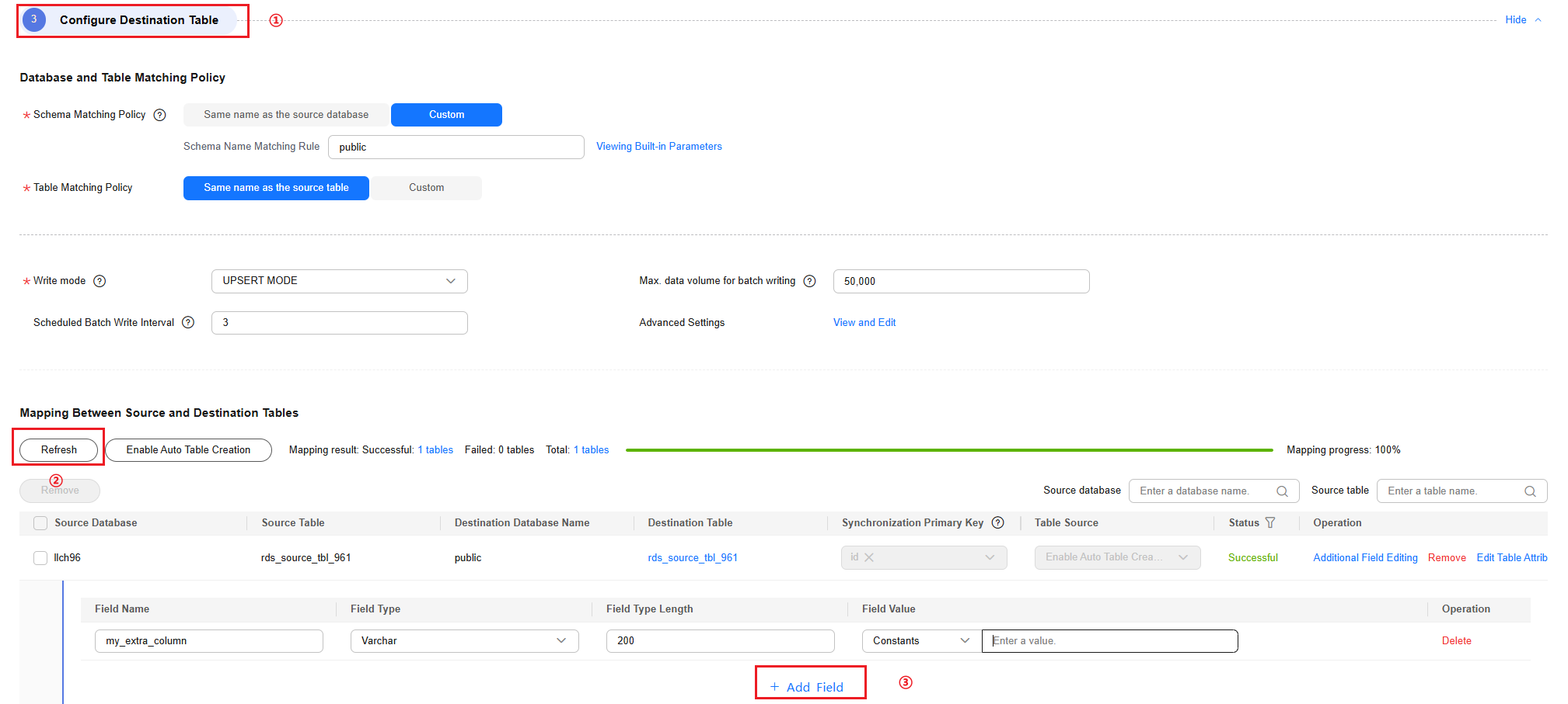

Configuring Additional Fields
When editing a job, you can add additional fields to a specified table after refreshing the mapping between the source table and destination table.
Figure 1 Configuring additional fields
Configure an additional field as follows:
  • Field Name: Do not use special characters in the field name. Only letters, digits, and underscores (_) are recommended.
  • Field Type: Select an appropriate field type as needed.
  • Field Value: Currently, the following field value types are supported: constant, built-in variable, field variable, and UDF.
    During automatic table creation, additional fields are added to the destination table structure by default.

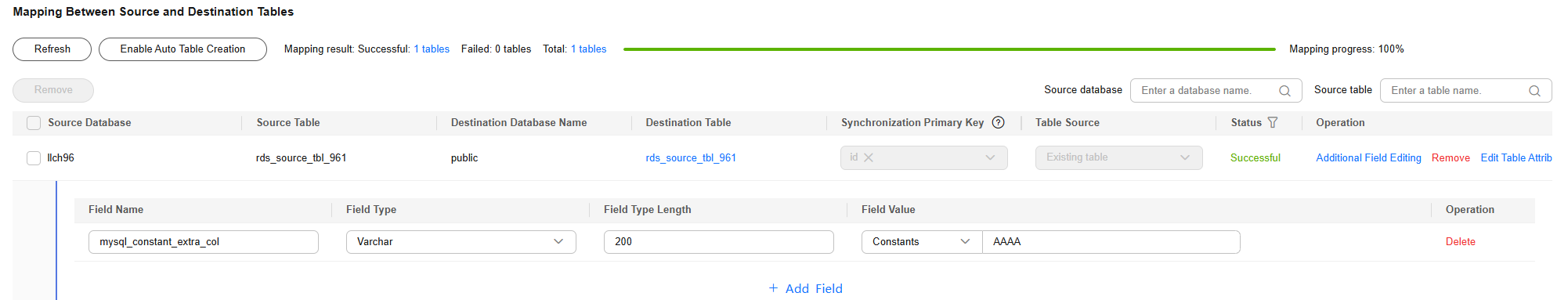

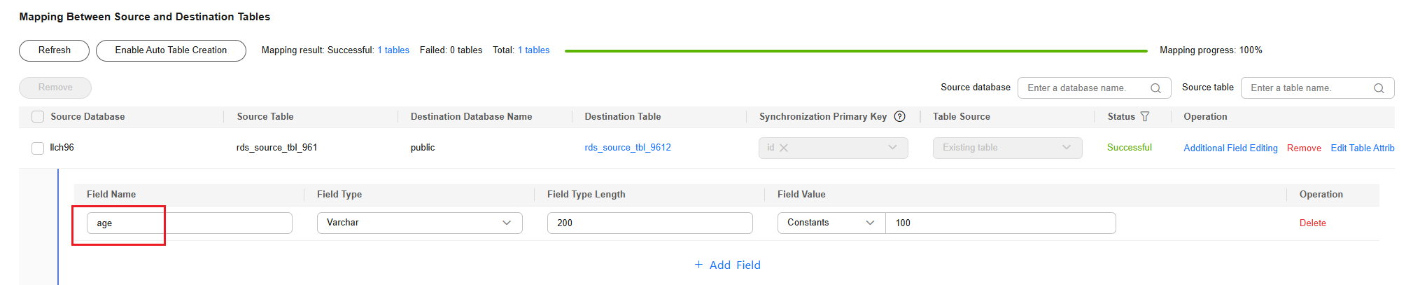

  • Constants
    • Parameter description: When the field value is a constant, set it to a fixed value.
    • Job example: As shown in the following figure, the query result of the mysql_constant_extra_col field at the migration destination is fixed at AAAA.
      Figure 2 Example constant value

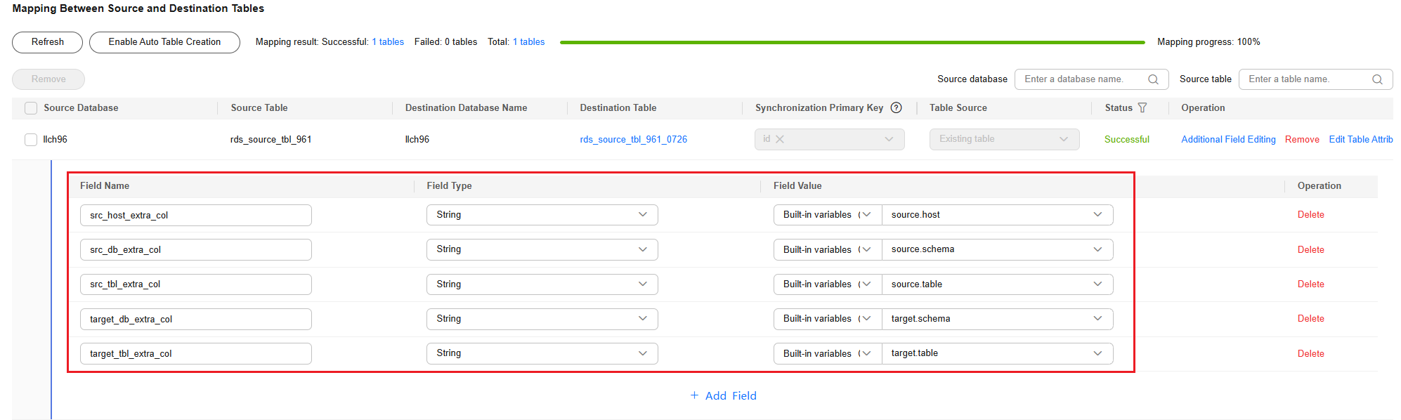

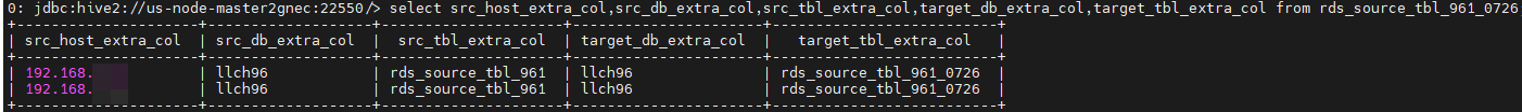

  • Built-in variables
    • Parameter description: Built-in variables support the following values. All of them are related to the data source metadata.
      • Source host IP address: source.
      • Source database name: source.schema
      • Source table name: source.table
      • Destination database name: target.schema
      • Destination table name: target.table
    • Example job: See the following figure.
      Figure 3 Example built-in variable
      View the output at the destination.
      Figure 4 Destination result

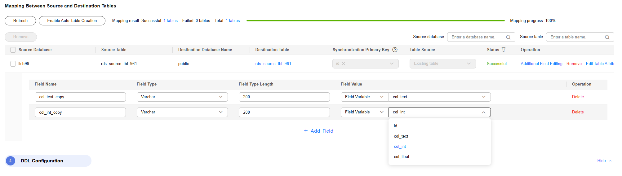

  • Field variables
    • Parameter description: A field variable fills an additional field with a field value in the source table. You can select a field name from the drop-down list or manually enter a source field name.
      Figure 5 Example value of a field variable

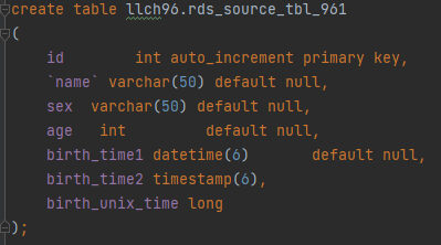

      The data in the source table llch96.rds_source_tbl_961 is as follows.
      Figure 6 Source table data

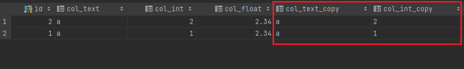

      After data is migrated to the destination, the input is as follows.
      Figure 7 Destination table data

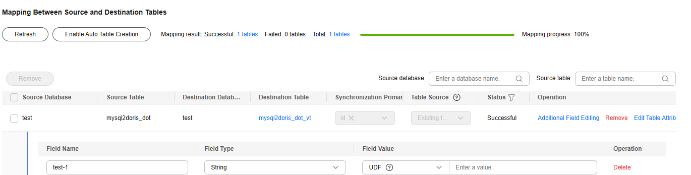

  • UDFs
    • Parameter description: If you select UDF for Field Value, you can select a UDF for performing secondary processing on the source field value before it is written to the additional field. The following UDFs are supported:
      • substring(#col, pos[, len]): obtains a substring of a specified length from the source column name. The substring range is [pos, pos+len).
      • date_format(#col, time_format[, src_tz, dst_tz]): formats the source column name based on a specified time format. The time zone can be converted using src_tz and dst_tz.
      • now([tz]): obtains the current time in a specified time zone.
      • if(cond_exp, str1, str2): returns str1 if the condition expression cond_exp is met and returns str2 otherwise.
      • concat(#col[, #str, ...]): concatenates multiple parameters, including source columns and strings.
      • from_unixtime(#col[, time_format]): formats a Unix timestamp based on a specified time format.
      • unix_timestamp(#col[, precision, time_format]): converts a time into a Unix timestamp of a specified time format and precision.
        Nested UDFs are supported. Example: substring(date_format(#col, yyyyMMdd), 0, 4)

    Figure 8 Example of the structure for creating a source table

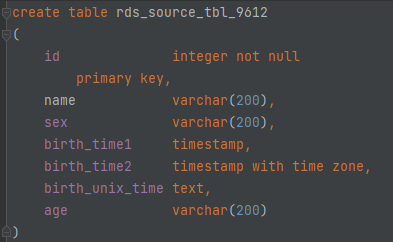

  1. View the structure of the source table.
    Figure 12 Structure of the source table

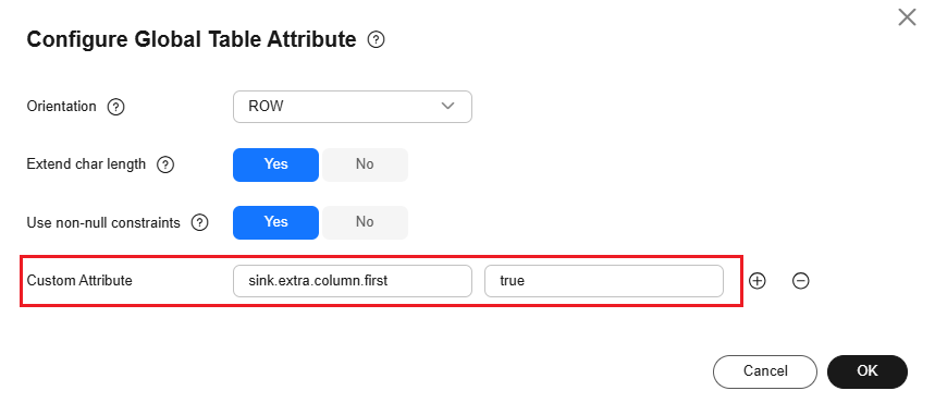

  4. Configure job parameters.
    Add sink.extra.column.first = true to the advanced settings of the destination.
    Figure 15 Adding custom parameters
  5. Check the change result.
    Figure 16 Refresh
    The value of the age field has been overwritten by that of the additional field.
    Figure 17 Viewing the change result
