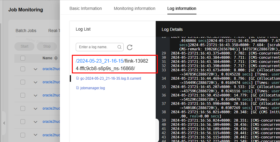

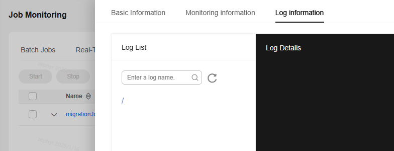

- On the details page, click the Log Information tab. In the log list on the left, click a log file to view the execution logs of the job in real time.
Figure 1 Log information 1Figure 2 Log information 2
- The topic of job logs can be changed.
- By default, job logs are updated in real time. You can disable the rolling update.
- You can download logs to a local path.
