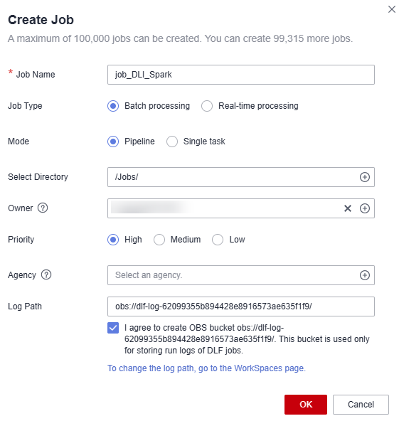

- In the navigation pane on the left, choose Data Development > Develop Job. In the displayed job list, locate the target directory, right-click it, and select Create Job. In the dialog box that appears, set Job Name to job_DLI_Spark and set other parameters as needed. Figure 2 Creating a job
