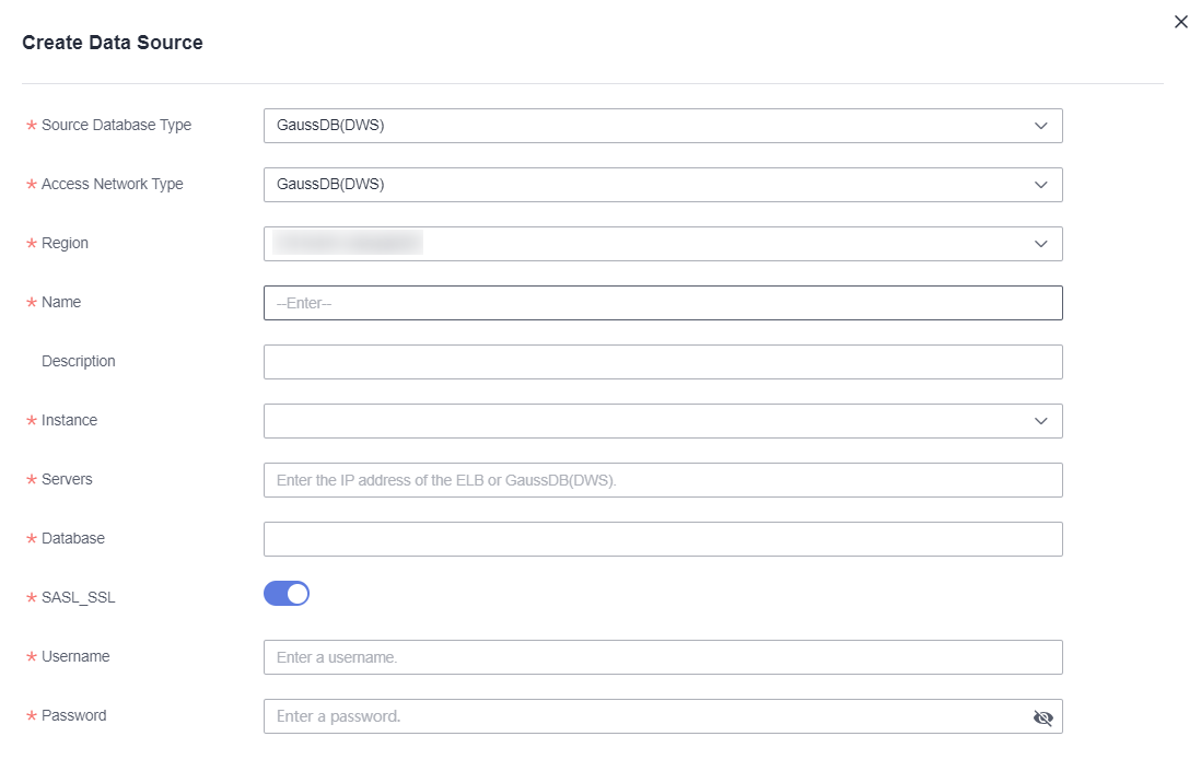

Accessing a GaussDB(DWS) Data Source Through a VPC Network
  1. Log in to the DataArts Insight console.
  2. Click in the upper left corner of the management console to select a region and select an enterprise project from Enterprise Project in the upper right corner of the Workspace page.
  3. On the top menu of the console, click Project. On the displayed My Projects page, click the name of the desired project.
  4. In the navigation pane on the left, choose Data Management > Data Sources. On the displayed page, click Create Data Source. In the slide-out panel, set Source Database Type to GaussDB(DWS) and Access Network Type to GaussDB(DWS).
  5. Set other parameters based on Table 2.
    Figure 2 VPC data source parameters
    Table 2 Parameters
    Parameter
    Mandatory
    Description
    Yes
    Type of the accessed data source. In this example, GaussDB(DWS) is selected.
    Access Network Type
    Yes
    Select GaussDB(DWS) for GaussDB(DWS) instances purchased under the current account. After this type is selected, the service directly calls the query API of GaussDB(DWS) to obtain the instance list and fill it into the Instance dropdown list.
    Region
    Yes
    Region where target instances are deployed. Currently, DataArts Insight only supports direct connection to GaussDB(DWS) instances within the same region. For cross-region scenarios, select another access network type.
    Name
    Yes
    Name the current data connection for easier subsequent use and configuration.
    Description
    No
    Supplementary information about the current data connection for future reference.
    Instance
    Yes
    List of GaussDB(DWS) service instances under the region corresponding to the current account, allowing direct selection for connection.
    Servers
    Yes
    Information about the node to be connected to the GaussDB(DWS) instance. You can obtain the information from the private IP address and port number in the Connection Information area on the GaussDB(DWS) instance details page.
    NOTE:
    If the cluster is associated with an ELB, the ELB address will be automatically populated. However, if there is no ELB associated with the cluster, the IP address and port number of the first node will be used by default.
    Database
    Yes
    Select the database in the target data source based on service requirements.
    SASL_SSL
    N/A
    It is used for trusted identity authentication and secure data transmission when DataArts Insight retrieves data from the data source. This function is enabled by default.
    Username
    Yes
    Username used for connection authentication.
    Password
    Yes
    Password used for connection authentication.
  6. Click Test Connection to test the data source connectivity.
  7. Once the test is successful, click OK.

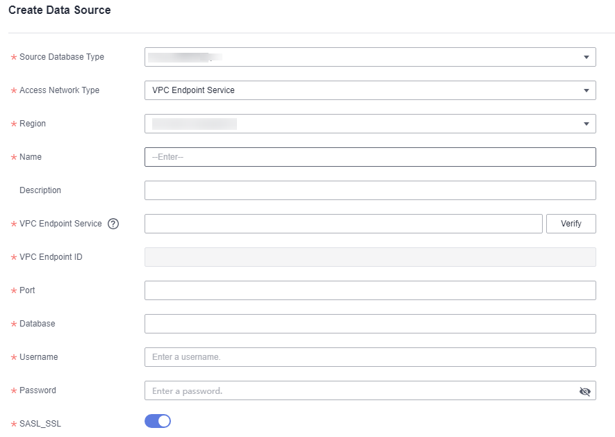

Connecting to a GaussDB(DWS) Data Source Through a VPC Endpoint Service
VPCEP enables connections to data sources using the VPCEP service name, offering flexible data access and addressing issues related to cross-account access and self-built data source access for ECS. Furthermore, the same main account and its IAM users can share a single connection channel, streamlining connection management. The existing access method eliminates the need for permission delegation, further simplifying operations.
  • Prerequisites
  • Procedure
    3. On the top of the console, click Projects and click the name of the desired project.
    4. In the navigation pane on the left, choose Data Management > Data Sources. On the displayed page, click Create Data Source. In the slide-out panel, set Source Database Type to GaussDB(DWS) and Access Network Type to VPC Endpoint Service.
    5. Set other parameters based on Table 3.
      Figure 4 Connection through a VPC endpoint service
      Table 3 Parameters
      Parameter
      Mandatory
      Description
      Yes
      Access Network Type
      Yes
      Select VPC Endpoint Service for GaussDB(DWS) instances under different accounts. If the instances do not have public IP addresses, you need to manually configure the VPCEP information to establish the network environment before setting up the connection.
      Region
      Yes
      Name
      Yes
      Description
      No
      Yes
      Name of the VPCEP service to be connected. The prerequisites for connecting to a VPCEP service are as follows:
      Verify
      N/A
      After entering the VPCEP service name, click Verify. If a green tick is displayed next to the VPC endpoint ID, the verification is successful. If a red exclamation mark () is displayed next to the VPC endpoint ID, the VPCEP service is connected to for the first time. In this case, you need to authorize the VPCEP service. To do so, log in to the VPCEP console. Under Network Console, choose VPC Endpoint > VPC Endpoint Services. On the displayed page, click the desired VPCEP service and click the Connection Management tab. On the tab page, authorize the VPCEP service. For details, see Managing Connections of a VPC Endpoint Service. Once the authorization is successful, click Verify again. The verification is successful.
      NOTE:
      • All initial connections to the VPCEP service from different data sources require approval.
      • Only an administrator account or an account with administrator privileges can approve the connection. If your current account does not have approval privileges, contact an administrator account for approval.
      VPC Endpoint ID
      Yes
      This parameter is automatically filled in once you entered the VPCEP name and clicked Verify.
      Port
      Yes
      External port of the target data source on the corresponding node, which can be obtained from the port number in the Connection Information area on the GaussDB(DWS) instance details page.
      Database
      Yes
      Username
      Yes
      Password
      Yes
      SASL_SSL
      N/A
