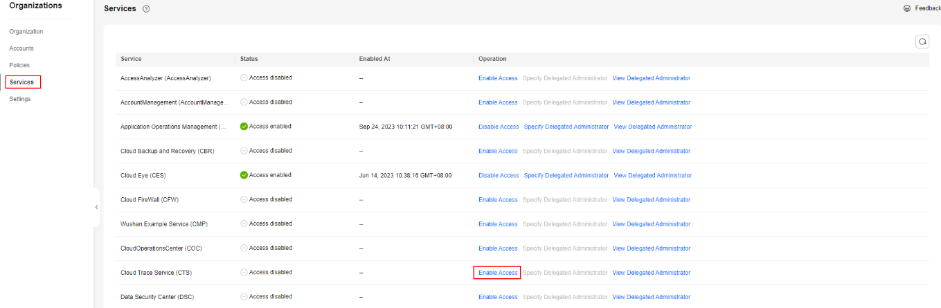

Setting CTS as a Trusted Service
- Click
in the upper left corner to select the desired region and project. - Click
in the upper left corner and choose Management & Governance > Organizations. - In the navigation pane, choose Services. On the displayed page, locate CTS and click Enable Access to set CTS as a trusted service.
Figure 1 Setting CTS as a trusted service

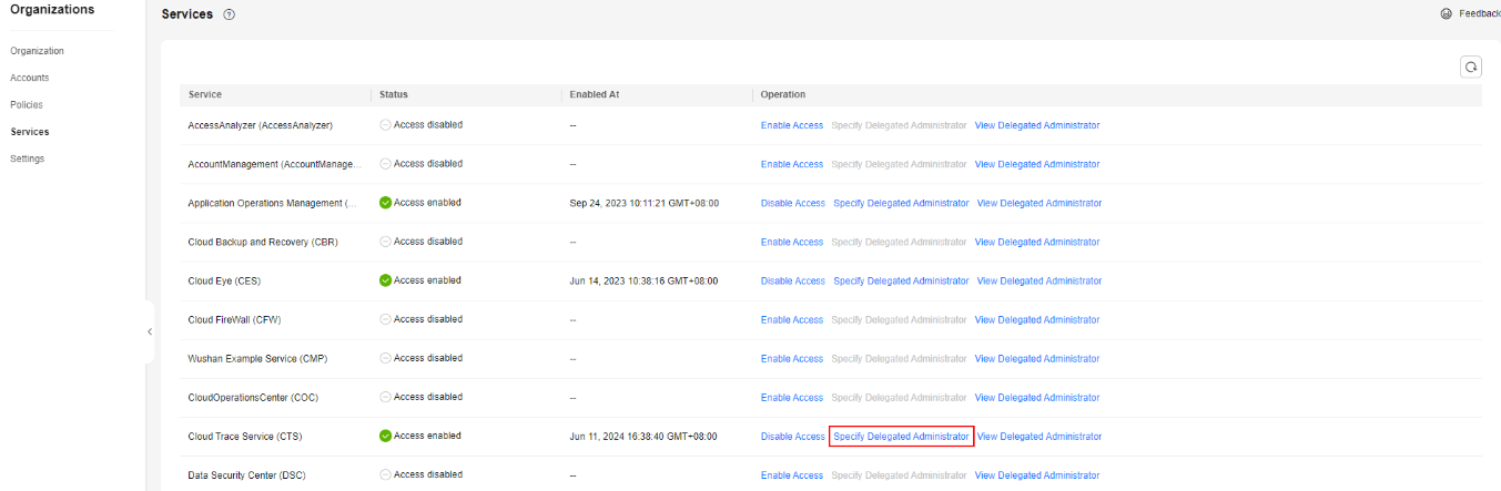

- Click Specify Delegated Administrator on the right of CTS to set a delegated administrator for CTS.
Figure 2 Specifying a delegated administrator
