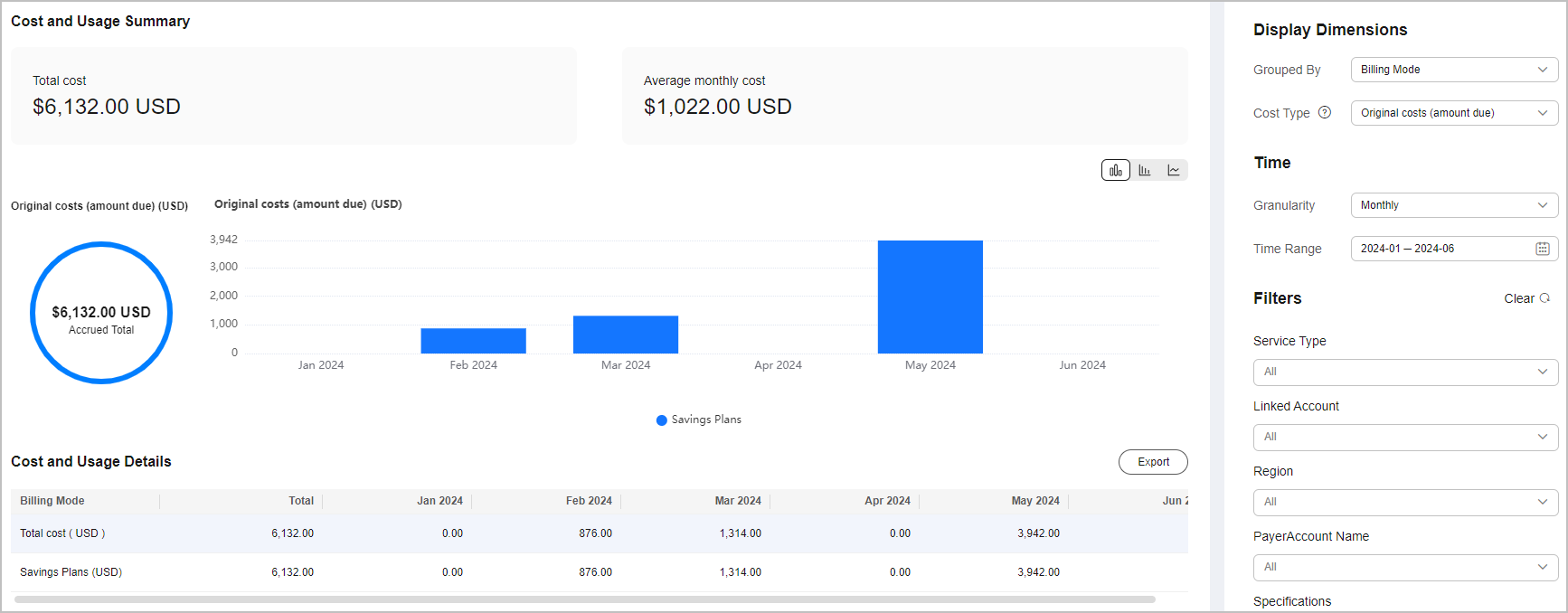

You can use the cost analysis function in Cost Center to view the original costs, amortized costs, and usage details of your purchased savings plans.
Viewing Original Costs
- Access the Cost Analysis page.
- Set Grouped By to Billing Mode. Under Filters, include Savings Plans in Billing Mode.
- View the original costs of your savings plans over the selected period.
- View the details of the original costs.
