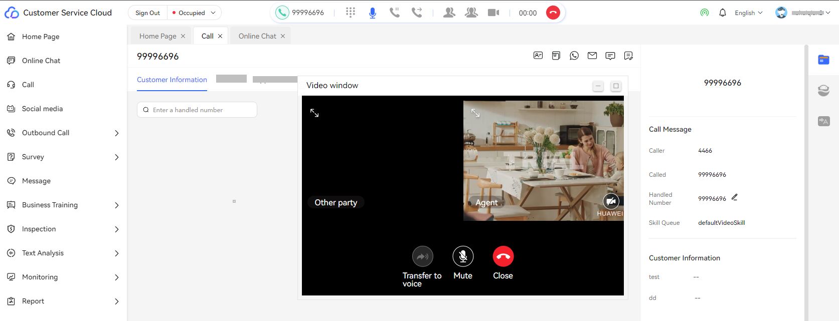

  4. Initiate a video call.
    1. Click , enter a softphone number, and make a call. The call can be a video call.
      • A WebRTC phone can make outbound calls only when it is registered and the agent has signed in.
      • When you dial the number for the first time, the message "xxx.xxx.xxx.xxx wants to use your camera" is displayed. Click Allow.
    2. Click Answer to answer a ringing call as an agent. The customer's phone then rings and waits for the customer to answer the call.
      The WebRTC phone is in talking state and displayed in green, and the agent is in occupied state. The following figure shows a video call.
      Only the local video window is displayed.
      Click on the connection bar to share a specified area, which can be:
      • Entire screen
      • Application window
      • Browser tab page
      • In pool mode, either of the two phones is used randomly.
      • Pay attention to personal privacy protection during desktop sharing.
    3. (Optional) After the video call is connected, check whether the following page is displayed.
      : Disable the camera.
      : Zoom in the window.
      : Hide the video window and display the call duration ().
      : Display the fullscreen video window.
      : Switch to a voice call or resume a video call. Click the button for switching between voice and video calls on the connection bar and select a video call.
      : Mute yourself and click again to unmute yourself.
      : Hang up the current call.
