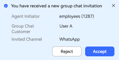

- Click Confirm to send the group chat invitation and wait for the invited agent to respond. Figure 3 Page of an invited agent
If the invited agent accepts the group chat invitation, the pages of the two agents are displayed as follows.
Figure 4 Page of an invited agent joining a group chat
Figure 5 Page of an invited agent
