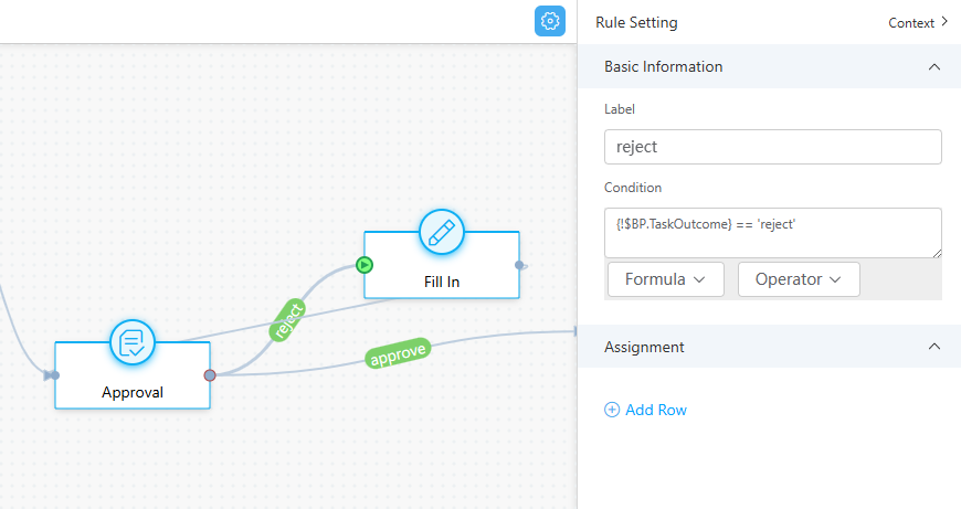

Connecting line
- For the approve connecting line, as shown in Figure 4, enter {!$BP.TaskOutcome} == 'approve' in the Condition text box.
- For the reject connecting line, as shown in Figure 3, enter {!$BP.TaskOutcome} == 'reject' in the Condition text box.
