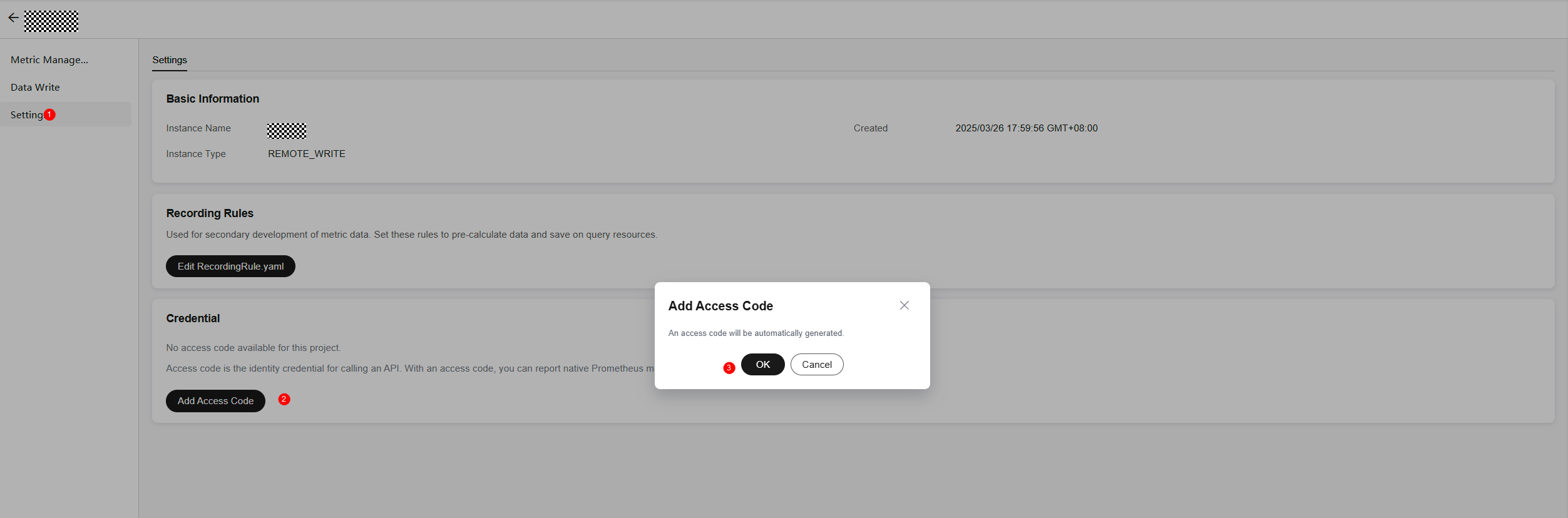

  1. Click the name of the created Prometheus instance.
  2. In the navigation pane, choose Settings. In the Credential area, click Add Access Code. Click OK.
  3. Obtain the values of <project_id>, <aom_id>, and <aom_secret>.
    Combine them into the following string, ensuring there is a space after each colon:
    <project_id>_<aom_id>: <aom_secret>
