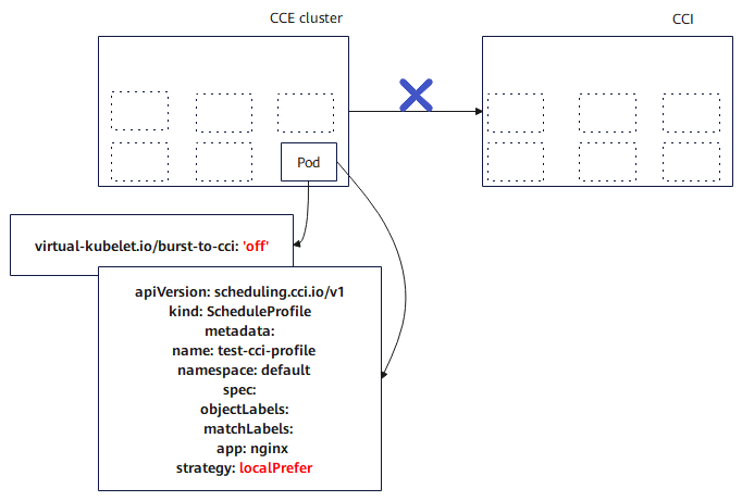

Both a label and a ScheduleProfile are used to schedule the workloads to CCI 2.0.
The scheduling priority of the label is higher than that of the profile.
For example, if the scheduling policy of the label is off and the scheduling policy of the ScheduleProfile is set to enforce, the workloads will not be scheduled to CCI 2.0.

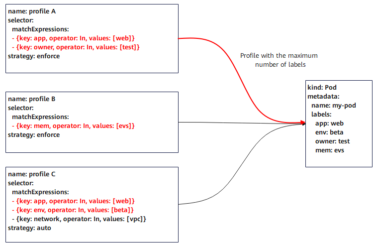

There are multiple profiles specified for a pod.
A pod can only have one profile. If a pod has multiple profiles, the profile that can associate the maximum of labels is used. If there are multiple profiles that can associate an equal number of labels, the profile whose name has the smallest alphabetical order is used.
In this figure, the pod is finally associated with profile A.
