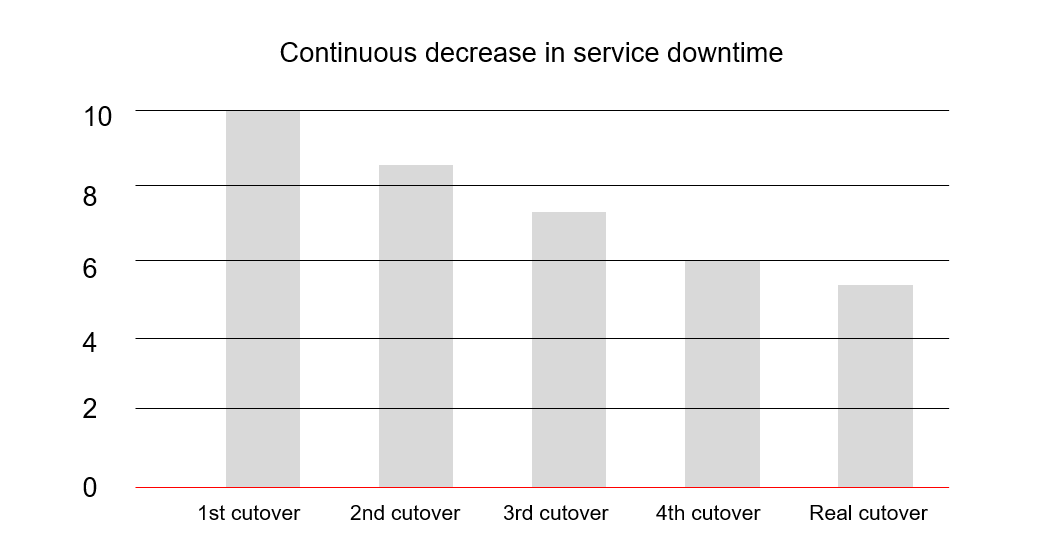

- Minimizing downtime: A large-scale system cutover often involves more than 200 steps, requiring parallel and serial operations and collaboration among multiple roles and personnel. The Mock cutover can improve the team's familiarity with cutover operations, coordination between parties, and problem-solving efficiency. For steps that take a long time, automatic scripts can be used to replace manual operations or further script optimization can be conducted to reduce the downtime caused by the cutover. For example, a solution where all service systems are cut over at a time was adopted for the cloud migration of a large retail platform. After four mock cutovers, the cutover time was shortened by 40%. Figure 1 Cutover results

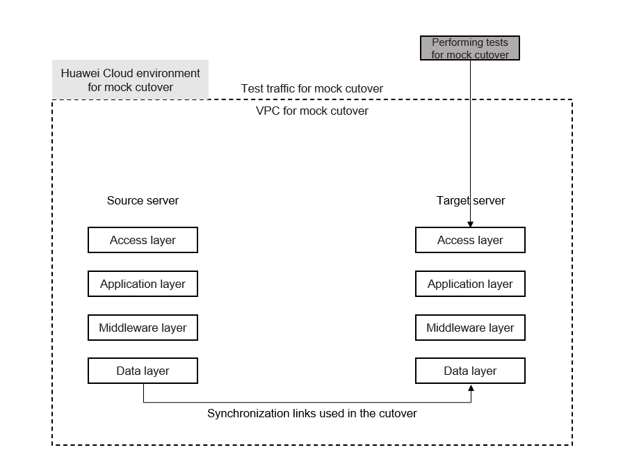

- If no test environment that is similar to the production environment is available in enterprises, deploy both the complete source and target environments on Huawei Cloud for the mock cutover. Figure 3 Cutover environment

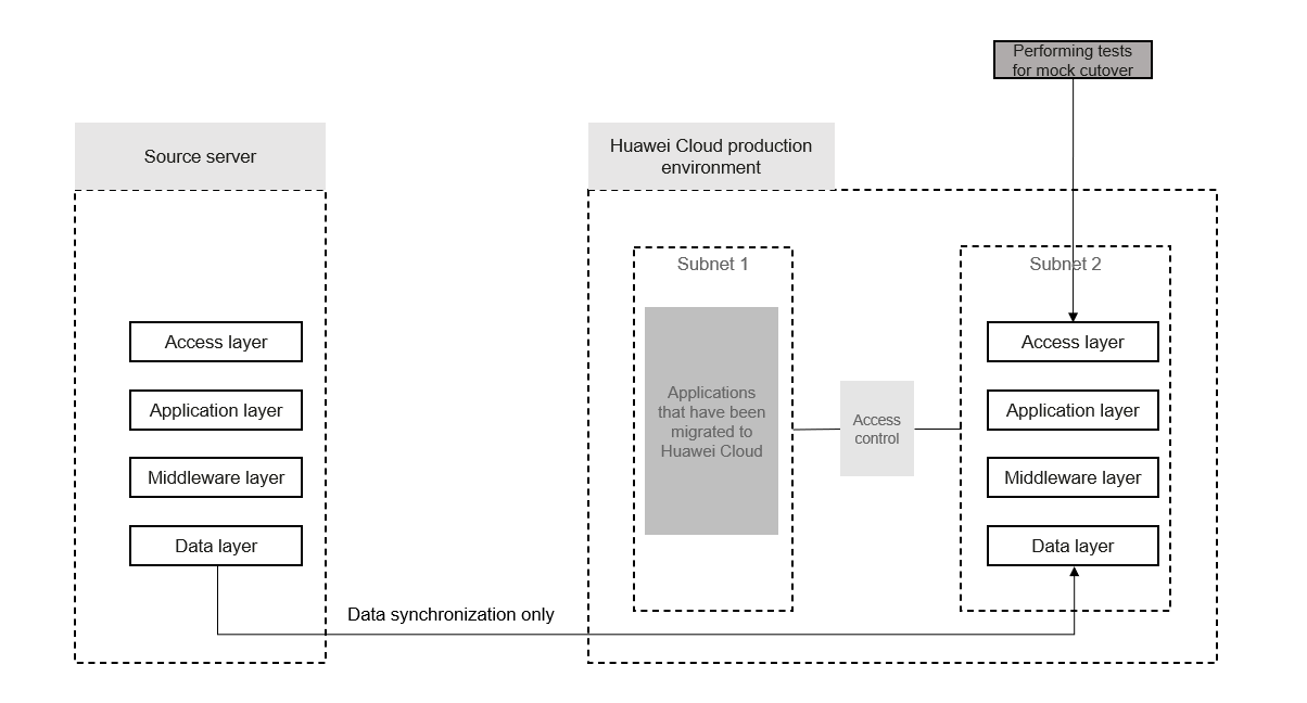

- If a test or pre-production environment is available for use as the source environment in enterprises, deploy only the target environment on Huawei Cloud. The production environment on Huawei Cloud may be reused as the target environment. In this case, strict isolation measures must be implemented to prevent the mock cutover from affecting the live production system. Figure 4 Cutover environment
