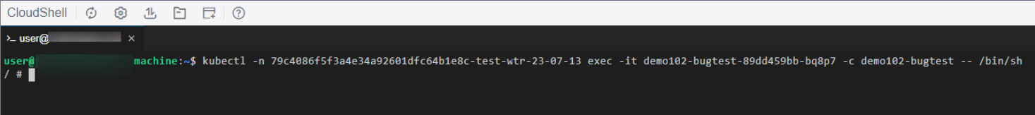

  7. Switch to CloudShell, initialize kubectl, and run the kubectl exec command to log in to the container.
    Wait until the kubectl exec command is automatically executed.
    Figure 1 Running the kubectl exec command to log in to the container
