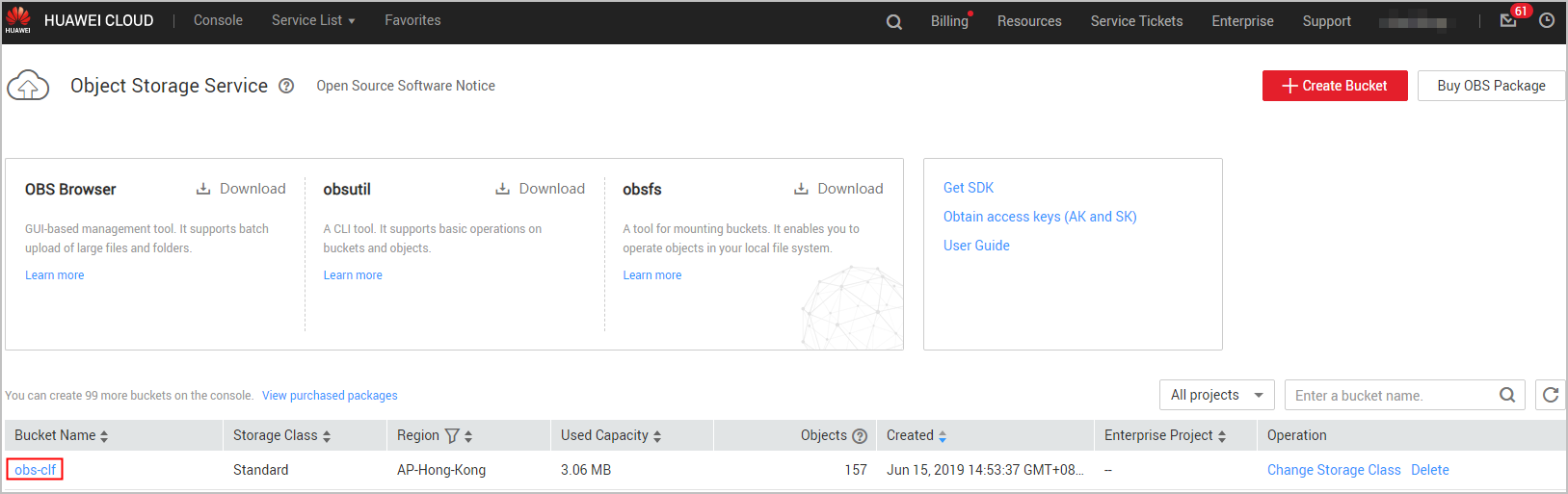

  1. Choose Service List > Storage > Object Storage Service.
  2. Click the bucket name.

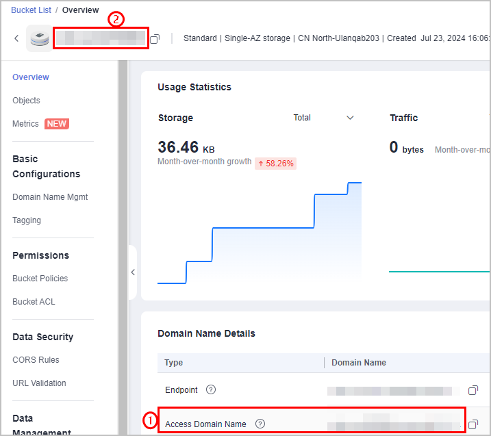

Parameter description:
  • AK: access key ID on OBS. One AK maps to only one user but one user can have multiple AKs. OBS identifies users via access key IDs. For details about how to obtain the AK and SK, see Obtaining Access Keys (AK and SK).
  • SK: secret access key used to access OBS. Authentication information is generated based on SKs and request headers. Each AK maps onto a unique SK.
  • server: domain name, representing the bucket's Internet address. It is used for direct access to buckets in cases like cloud application development and data sharing. You can obtain its value from the part marked with ① in Figure 1.
  • bucketName: name of the bucket used for the subscribed bills. You can obtain its value from the part marked with ② in Figure 1.
  • prefix: bills that need to be automatically downloaded.
    • "Resource_Expenditures_": resource expenditure records
    • "Spendings (ByResource)_": resource bill
  • localFileDir: local directory for storing downloaded bill files.
    Figure 1 Obtaining parameters for automatically downloading subscribed bills
