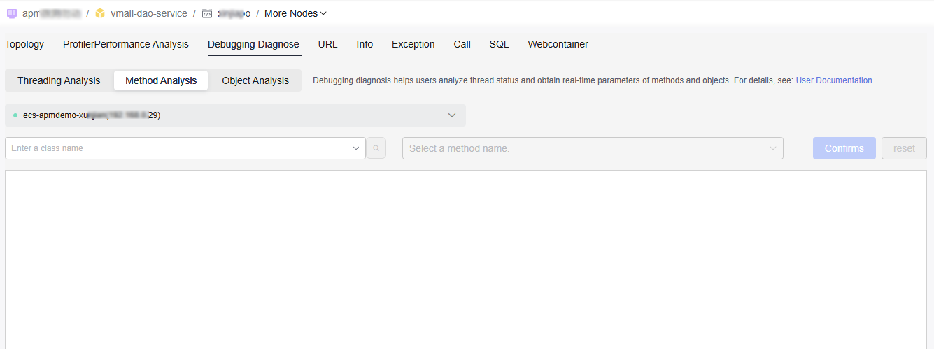

  5. Click the Debugging Diagnosis tab.
  6. Click Method Analysis. The Method Analysis page is displayed.
    Figure 1 Method analysis

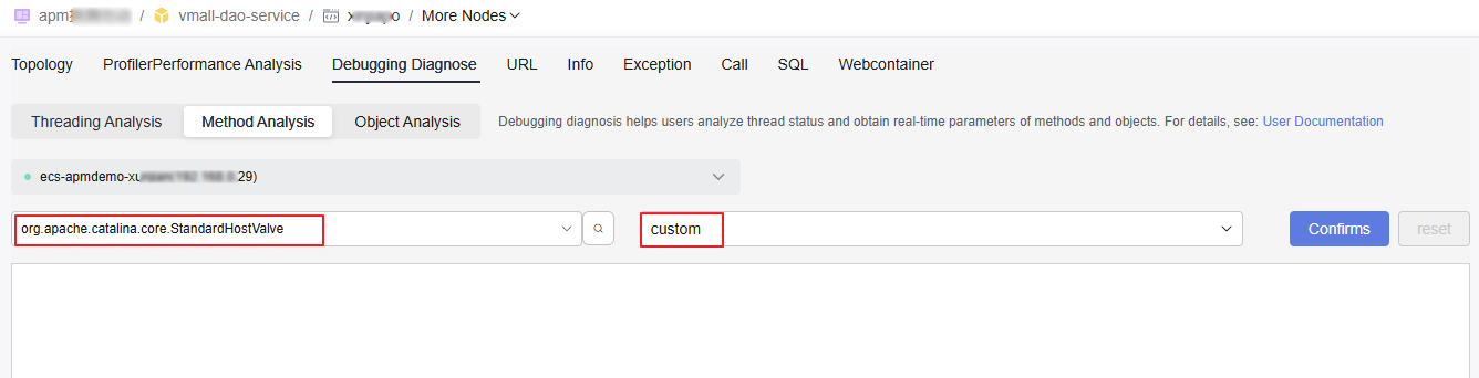

  7. In the Enter a class name text box, enter a class name. Click and select a class name from the drop-down list.
    In the Select a method name text box, select a method name. Click Confirm. The execution information of the method is displayed.
    Figure 2 Class name and method name

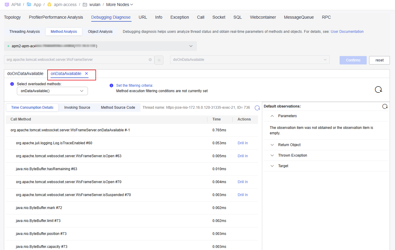

    • The execution records of the method are displayed on the left of the page, including Time Consumption Details, Invoking Source, and Method Source Code.
      1. Time Consumption Details: include the call method, time consumed, and drill-in operation.

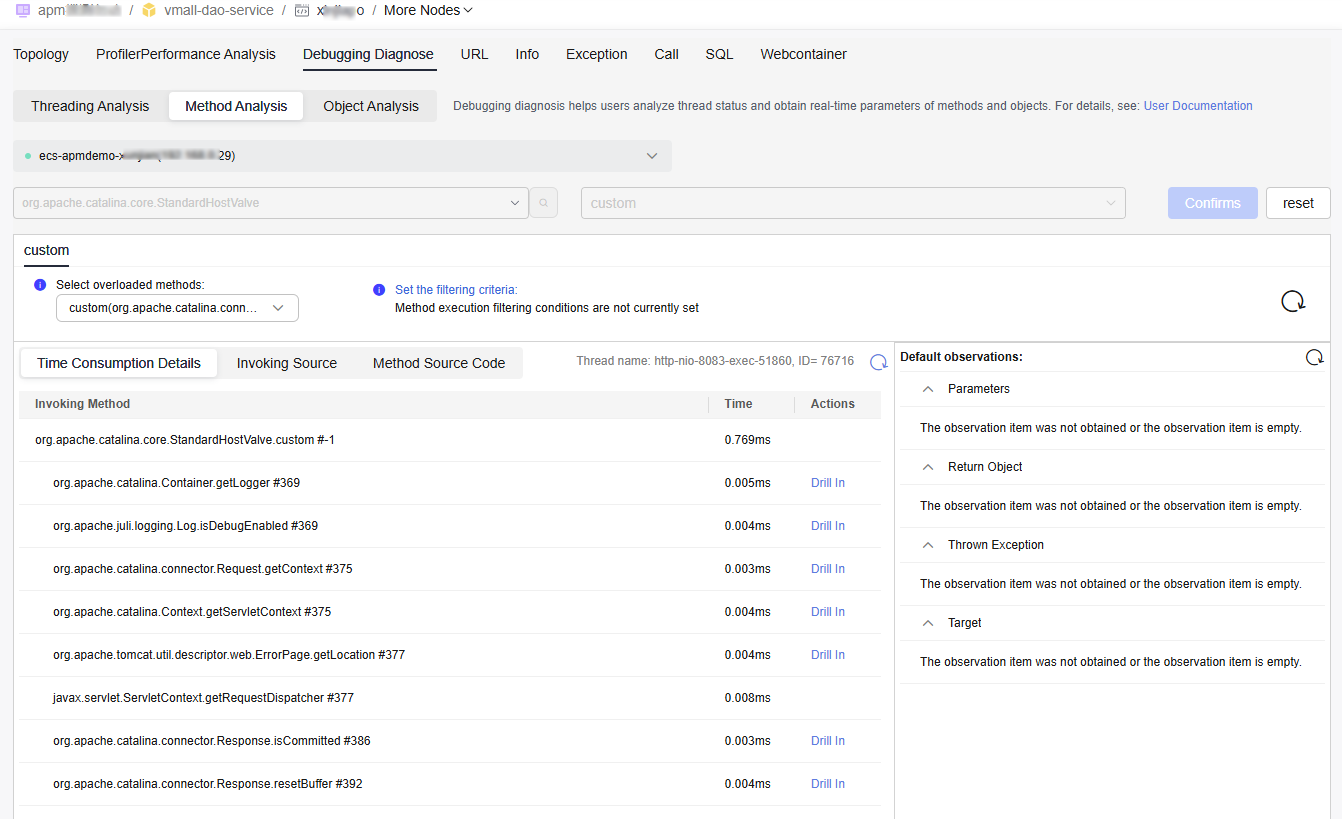

      2. Click Drill In to view details about the called method.
        Figure 4 Drill-down

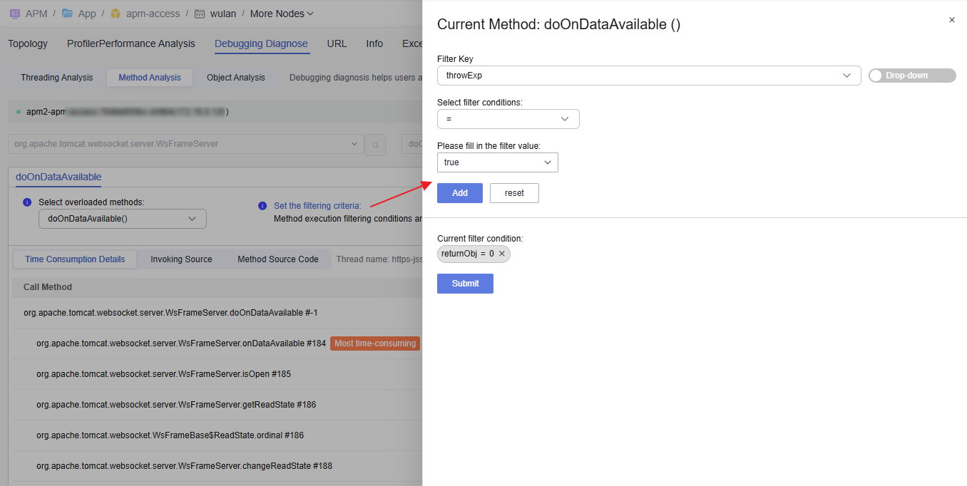

    • Set the filtering criteria: Filter method records that meet specified criteria.
      Figure 5 Setting the filtering criteria
      1. Select a filter key from the drop-down list or enter one.
      2. Select a filter criterion from the drop-down list.
      3. Enter a filter value.
      4. Click Add. The filter criteria will be displayed in the current dialog box.
      5. Click Submit to complete the configuration.
