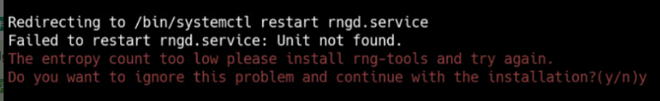

Symptom
When you tried to install the MgC Agent on a Linux server, a message was displayed indicating that the entropy was insufficient and rng-tools needed to be installed.
Possible Causes
The MgC Agent installation requires the server's entropy level to be greater than 1,000. If the entropy is insufficient, the installation will fail.
