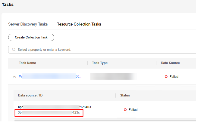

If a collection task fails, you can perform the following operations to obtain the existing collection records:
  1. In the task list, click the drop-down arrow to obtain the data source ID of the task. If the data source ID is not found, submit a service ticket to contact technical support for fault locating and rectification.
  2. Locate the failed task and click View Storage Path in the Operation column to obtain the CSV file path.
  3. Navigate to the MgC Agent installation directory and go to the path of the obtained CSV file. In the path, search for the CSV file with the same name as the obtained data source ID. If the CSV file is not found, the collection was not completed. In this case, you are advised to create a collection task again.
