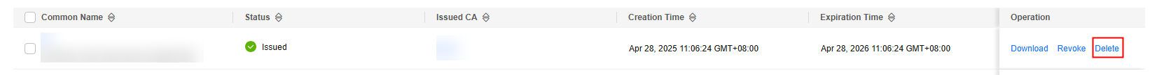

- Locate the row of the private certificate to be deleted and click Delete in the Operation column.
Figure 1 Deleting a private certificate

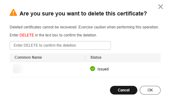

- In the displayed dialog box, enter DELETE to confirm the deletion.
Figure 2 Delete Certificate
- Click OK. If message "Certificate xxx deleted successfully." is displayed in the upper right corner of the page, the private certificate is deleted successfully.
