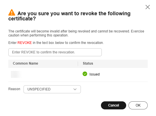

 - In the displayed dialog box, enter REVOKE and select the revocation reason to confirm the revocation. The default revocation reason is in the UNSPECIFIED field. Table 1 describes the revocation reasons you can select.
    Figure 2 Revoke Certificate

 - Click OK.
When "Certificate xxx revoked successfully" is displayed in the upper right corner of the page, and the private certificate status changes to Revoked, the private certificate is revoked successfully.
