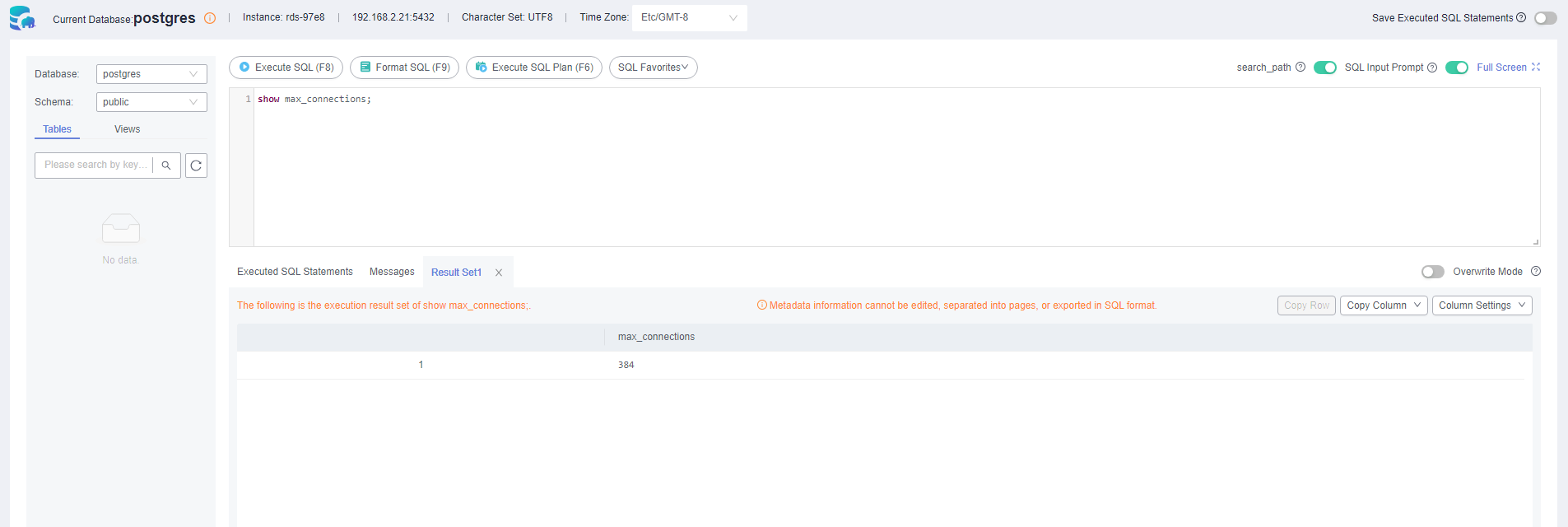

- You can run the following command to query the maximum number of connections allowed:
show max_connections;
