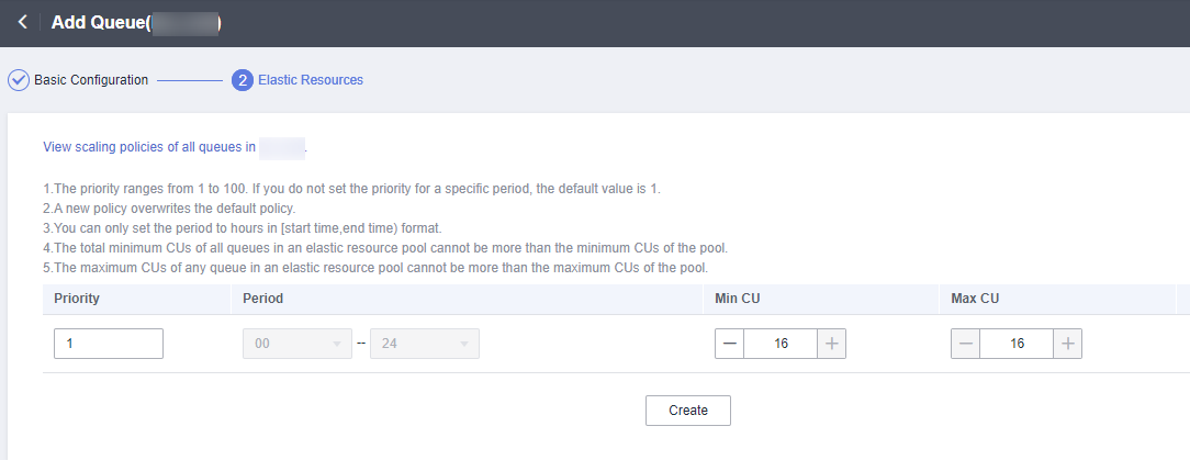

  9. Click Next and configure scaling policies for the queue.
    Click Create to add a scaling policy with varying priority, period, minimum CUs, and maximum CUs.
    Figure 2 shows the scaling policy configured in this example.
    Figure 2 Configuring a scaling policy when adding a queue
    Table 4 Scaling policy parameters
    Parameter
    Description
    Example Value
    Priority
    Priority of the scaling policy in the current elastic resource pool. A larger value indicates a higher priority. In this example, only one scaling policy is configured, so its priority is set to 1 by default.
    Period
    The first scaling policy is the default policy, and its Period parameter configuration cannot be deleted or modified.
    The period for the scaling policy is from 00 to 24.
    00-24
    Min CU
    Minimum number of CUs allowed by the scaling policy
    16
    Max CU
    Maximum number of CUs allowed by the scaling policy.
    64
