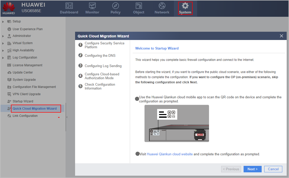

- Access the standard configuration page at https://192.168.0.1:8443 and choose . On the page that is displayed, click Next.
Figure 1 Quick cloud migration wizard

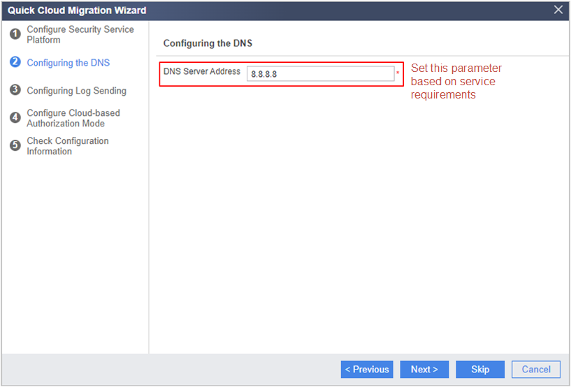

- Configure the DNS server address and click Next.
Figure 3 Configuring a DNS server

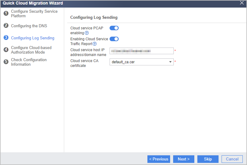

- Configure log sending as shown in the following figure and click Next.
Cloud service host IP address/domain name indicates the address or domain name used by the device to send logs to the cloud. Set this parameter based on the actual address or domain name of the target site.
Figure 4 Configuring log sending

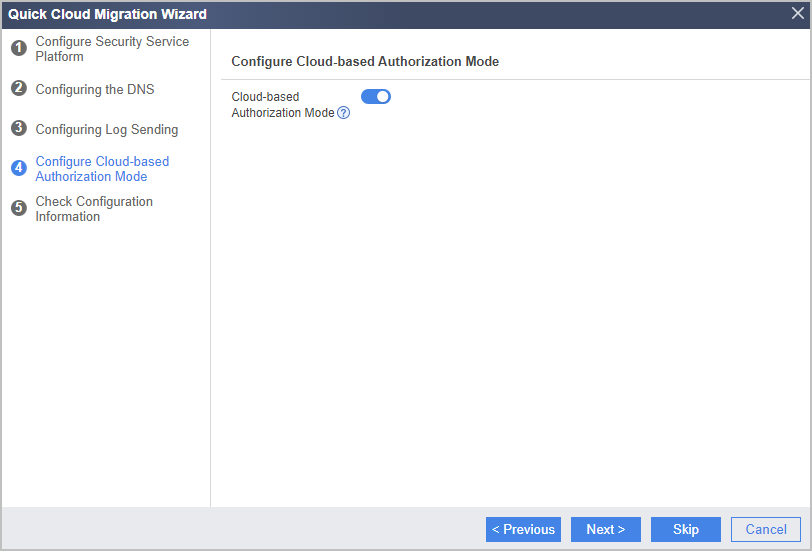

- Enable the cloud-based authorization mode and click Next.
Figure 5 Enabling the cloud-based authorization mode

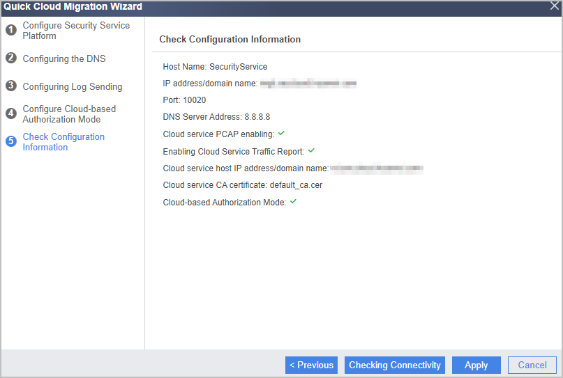

- Verify configurations and click Checking Connectivity.
Figure 6 Checking connectivity

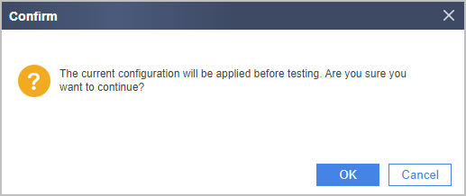

- In the displayed dialog box, click OK to continue the connectivity test.
Figure 7 Configuration delivery prompt

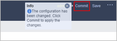

- Click Commit at the upper right corner of the page and commit the configuration as prompted.
Figure 8 Committing the configuration
